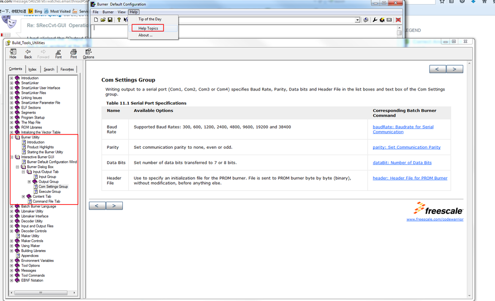

Hello Ray ,
Please refer to here https://community.freescale.com/message/540258?et=watches.email.thread#540258
there is a video to show how to use the SRecCvt-GUI,
And also , if you use the CodeWarrior IDE ,
you can use the converter the CodeWarrior itself , here you can find :
..\Freescale\CW MCU v10.6\MCU\prog\burner.exe  , this is the CW10.6 version , other versions also have .
Hope it helps
Alice

rayhall
Contributor V
Alice,
The video did not help. I still get the error message and no file is created.
I used the burner program and it created the file without problems. But I have some questions about the burner program.
1. How does it know what MCU the ABS file is from.
2. Why does it have the option to send to a COM port.
3. Can the burner program load new firmware without the need for a bootloader.
The help file for the burner is not clear as to what it is for.
Ray.

Hello Ray,
About the detail information , i strongly recommend you refer to the help , here :
After you check this , if you still have any question , please tell me !
Hope it helps
Alice
