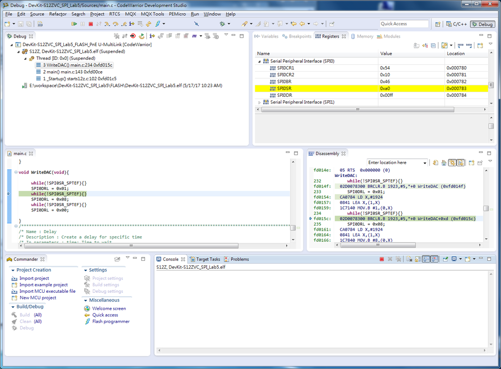

I am new user using S12ZVCA. I already make a board(refer DEVKIT-S12ZVC). And it work fine.
I  am excised GPIO(DEVKIT-S12ZVC_LAB1GPIO.zip) and it work fine.
But, I have issue on SPI(DEVKIT-S12ZVC_LAB5SPI.zip). I don't know how to use Processor Expert.
My 1st project need using ADC(HVI) to measure 0~10V. And transmit data using SPI. And control some GPIO.
Do you have other SPI example without Processor Expert? What is best way for my 1st project?

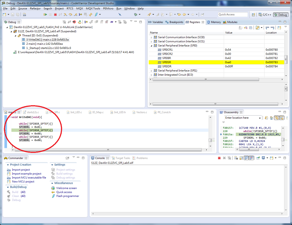

aaronlee
Contributor V
I can not write new value to SPI0DR. The register of SPI0DR is always 0x00ff. Why?

aaronlee
Contributor V
The SPIF (SPI0SR) flag is clear before write 0x01 into SPI0DR.
execute next step, the SPI0SR change to 0xa0.
It mean the SPIF (SPI0SR) flag is set after write 0x01 into SPI0DR.
but I can not see the SPI0DR=0x01. Why?

danielmartynek
Hi Aaron,
I have tested the SPI on a simple example code and the behavior you describe is correct.
I have the same results and I can read the data on pins.
The SPI0DRL register is not a regular register.
When you write to it, you write to TX register and it is immediately transmitted to shift register.
The 0x00FF is probably a mask, it means you have configured 8-bit transfer width.
In case SPI0CR2_XFRW == 1 (16-bit transfer width), the mask is then 0xFFFF.

aaronlee
Contributor V
Hi, Daniel,
Now it can working. Thank you.
