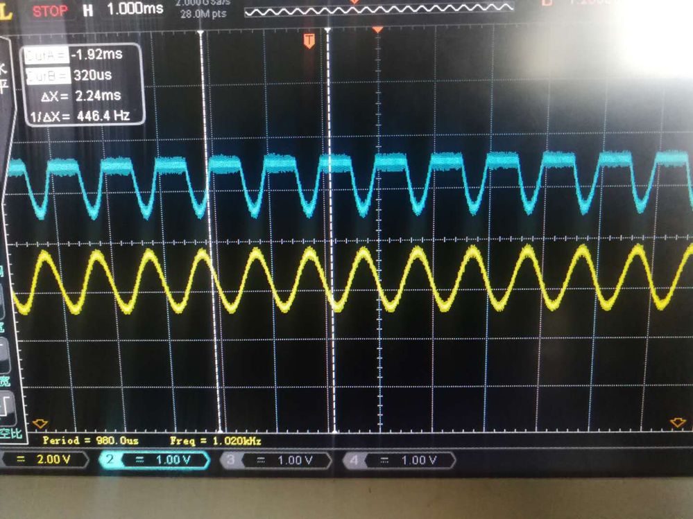

使用2.048M晶振,3V供电.VDDD1.5V内部供电
使用CHIP_ANA_TEST1寄存器 对SGTL5000进行测试
MIC接口加信号源: 2V ,1KHz
CHIP_ANA_TEST1.TM_SELECT_MIC 置1
(Enable the mic-adc-dac-HP path)
即CHIP_ANA_TEST1.TM_SELECT_MIC=0x0001;
示波器波形为(黄色为信号源 蓝色为HPout)
[2.048m crystal oscillator,3V power supply, vddd1.5v internal power supply
The SGTL5000 is tested with the CHIP_ANA_TEST1 register
MIC interface plus signal source: 2V,1KHz
CHIP_ANA_TEST1. TM_SELECT_MIC buy 1
(to Enable the mic - adc and dac - HP path)
Namely CHIP_ANA_TEST1. TM_SELECT_MIC = 0 x0001;
Oscilloscope waveform is (yellow is the signal source and blue is HPout)]

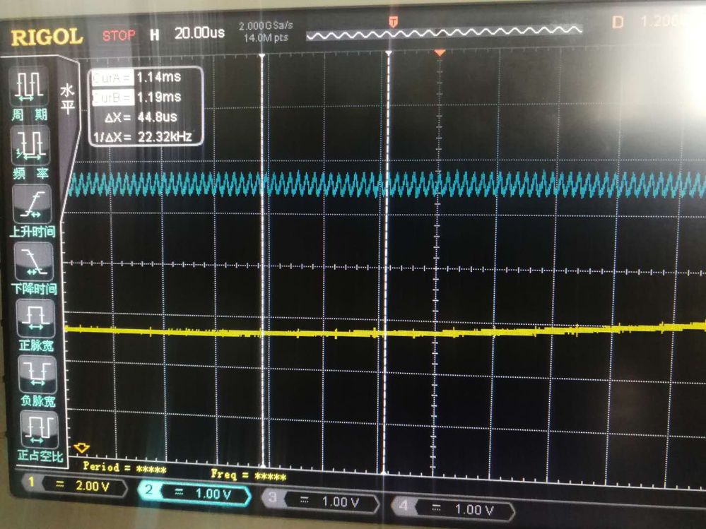

将CHIP_ANA_TEST1.TM_ADCIN_TOHP=0x0001示波器波形为(黄色为信号源 蓝色为HPout))
输出信号已经畸变,
[Chip_ana_test1.tm_adcin_tohp =0x0001 oscilloscope waveform is (yellow is the signal source and blue is HPout))
能否告诉我哪里出了问题
这是我的寄存器配置:
[Can you tell me what went wrong
This is my register configuration:]
