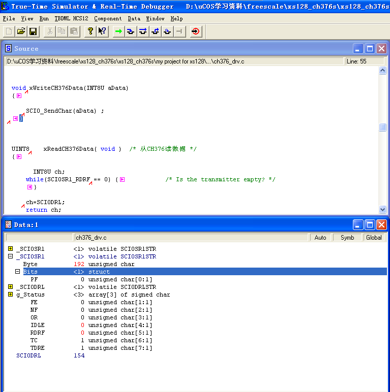

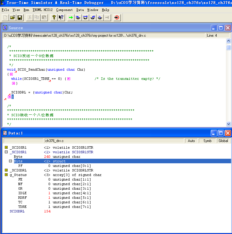

this is my code,
when I debug my program I found when a data is coming, RDRF register will be set 1,and SCI0DRL's value is correct.
But,when I clicked single step,
the RDRF reset,become 0
It makes me cant read what is coming in xReadData and code will be run in a dead loop.

This is known debugging issue.
The problem is that RDRF flag is cleared by reading of SCISR register followed by reading SCIDR register.
When we stop MCU at start of interrupt routine by breakpoint, debugger will automatically read content of registers (and memory) and this way also clear RDRF flag.
Solution: You have to store SCISR register value to some variable at begin of interrupt routine and place breakpoint below this command. After that you could test that variable instead SCISR register for flags.
So, after reaching breakpoint, you could continue in stepping over code.

xianyu
Does it means when I use debugger and click single step,the data1 window's change do read SCISR1 register.
That operation makes RDRF register turn to 0 and Flag be cleared.
let me try to save SCISR1 register when the data come.
