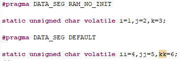

Hello Team,
we need to preserve one RAM location after COP reset.
please suggest, how we can achieve this in S12ZVL ?
Charudatta

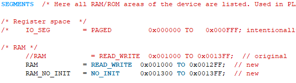

Of course there is also another possibility which ensures no automatic access of CodeWarrior Initialization procedures to the RAM. The way is modificatin of the PRM file.
Modify RAM segment...split it to segment controlled by CW and segment not initialized.
and also Placement :
Then, In the main.c file I will use two different approaches to visualize performance :
note, I used static  and volatile qualifiers to avoid optimization process to exclude variables from the code.
After reset (stopped at the beginning/top of the main() function) I can see i, j, k as no initialized but ii, jj, kk are initialized after Start12z file processing.

... and now reset, then after execution of Start 12z.c and stopped at the beginning/top of the main() function I can see:
....soft reset has not changed content of i, j, k  (even I used initialization "static unsigned char volatile i=1,j=2,k=3;" but PLACEMENT to NO_INIT section has higher priority).
Result....ii, jj, kk are always modified and initialized after reset in the initialization function placed in the Start12z.c file. i,j,k are not modified because they are placed in the RAM_NO_INIT, my user space, which is not initialized after reset what was defined in the prm file by creating exttra RAM space for unitialized variables.
I have provided you two different approaches and now it is up to you which one is more suitable for you or you can use combination of both of them.
