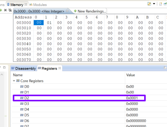

CW startup routine seems not waiting for RDY==1. But setting reset vector to iaprstvect() routine and power cycling board I see 0x0070 loop count @ 0x3000. :
void _Startup(void);
#pragma NO_RETURN
void iaprstvect(void)
__asm{
         CLR D2
rdlp:   INC D2
         BRCLR.B ECCSTAT, #0, rdlp
         ST D2, 0x3000  // save loop count
         JMP _Startup
Looks like it takes quite a lot at power on to initialize ECC RAM. Long enough for default startup routine to set stack pointer and jump (BSR) to DoZeroOut() routine before ECC RAM initialization completes! Are there chances for big failure like reading wrong address from stack when returning back from DoZeroOut() to _Startup()?

The counter showed 0x70.
But if the code is modified to write the SRAM while RDY == 0, the execution stalls at the ST instruction and the SRAM is written once the SRAM has become ready.

Thank you! I tried enabling TIM0 and using TCNT to measure RDY delay time. Waiting for RDY=1 with leading write to RAM vs no leading write to RAM produces about the same reading in TCNT and different loop counter. Yes, it looks like a stall. Clearly S12ZVC RM is wrong and should be fixed. This is what we have:
7.3.4 Memory Initialization
To avoid spurious ECC error reporting, memory operations that allow a read before a first write (like the
read-modify-write operation of the unaligned access) require that the memory contains valid ECC values
before the first read-modify-write access is performed. The ECC module provides logic to initialize the
complete memory content with zero during the power up phase. During the initialization process the access
to the SRAM is disabled and the RDY status bit is cleared. If the initialization process is done, SRAM
access is possible and the RDY status bit is set.
Access disabled(ignored) vs stalled are not the same things. Bold part sounds as if initialization may never complete.
