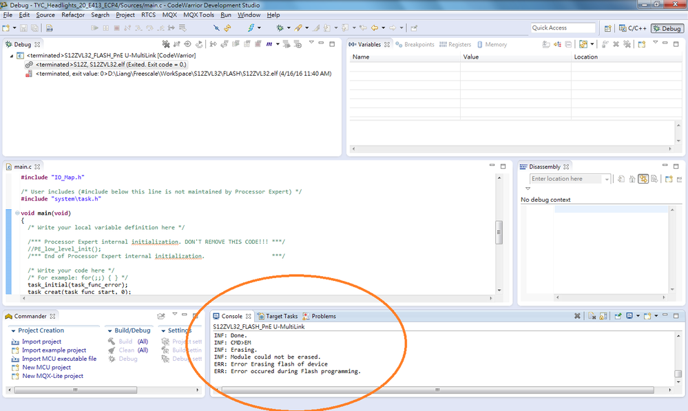

zongliangchan
circled it is a wrong message!
MCU = S12ZVL32
IDE  = CodeWarrior 10.6
Tool = USB-MultiLink
Please Help!

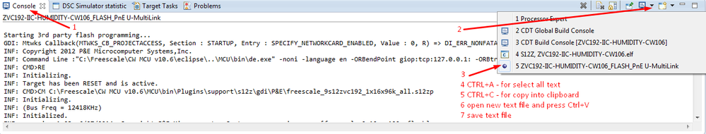

RadekS
Hi Zong,
Could you please share here the whole log from your console?
Files may be attached when you switch editor window into the advanced editor (in right upper corner).
Could you please also specify your operating system (USB BDM Multilink is not supported by PE drivers under Win10)?
It already worked before?
Are there any other error messages?
Could you please create a new empty project for S12ZVL32 and test load it into MCU?
Do you use any device which could externally reset MCU – for example, external watchdog?
If yes, please disconnect external reset from MCU during programming.
