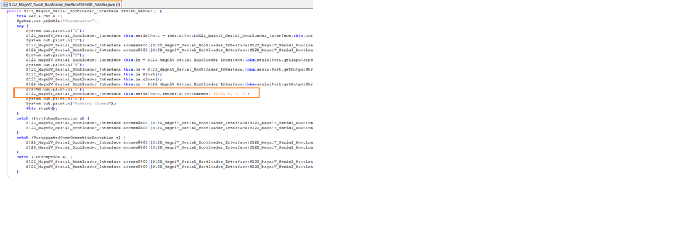

I looked into the "S12Z_MagniV_Serial_Bootloader_Interface.jar" file & found that in "S12Z_MagniV_Serial_Bootloader_Interface$SERIAL_Sender.class" file, for Serial Communication baud rate is set as 19200.[Line 75, attached .java file snapshot]Serial_Sender.png
I also tried, to compile the file in eclipse[attaching the original .jar files] but didn't make out successfully. Could you please help me out with the modifications?

Hi Priya,
The speed of MagniV_Serial_Bootloader_Interface is limited mainly by 200ms periodic task for sending data to MCU.
In attachment is updated version of this software from application engineer.
The possibility to change the target baud rate was added. However, some changes need to be made in the code warrior project to be able to simply modify the baud rate of the SCI module.
Attached example project is modified that makes the change of baudrate easier. In the comms.h file you will find a macro that contains the baud rate value.
#define BAUDRATE 115200
By changing this value, it changes the SCI baudrate configuration. In the comms.c you will find another macro that is the one that converts from an understandable value to the one that should be loaded in the register.
#define BAUD_VALUE 32000000/BAUDRATE
The 32000000 value represents the bus clock. The BAUD_VALUE is the one that is being loaded into the register.
According to application engineer measurements, the previously version it lasted about 8 minutes to load an 80Kb program, now it last 40 seconds.
Let me know if you have any troubles running the interface.
I hope it helps you.
Radek

priyagupta
Hi Radek,
      The attached new S12_MagniV_Bootloader_Interface PC application is working.
                 I am able to flash application with modified baudrate.
Thank you so much for your support...!!
