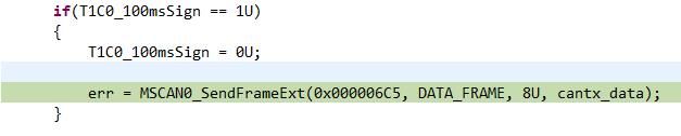

hello

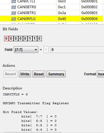

   when i call the function byte MSCAN0_SendFrameExt(dword MessageID,byte FrameType,byte Length,const byte *Data),
it returns ERR_TXFULL,i check the register CANTFLG = 0x00,it means message duffer is full,so i don`t konw why buffers are all full?

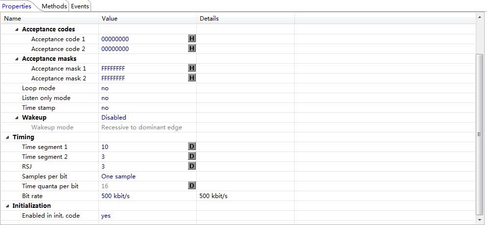

   i conncet a kvaser CAN data analysis as the other node,and this is my Processor Expert configuration
thanks.

Now I have the only question. Is your CAN bus connected to another node. The CAN is not working when there is no acknowledge from other node.
Loop-back mode helps you to say the CAN peripheral is OK and something wrong is on the BUS or transceiver.

hi lama,
now i found the reason,i forgot enable CAN Physical Layer control register,that`s the reason why loop-back mode runs without any problem but can`t send data to bus.

    thank you for your example code,but my mcu is S12ZVC64,so there`s something wrong when i debug it.
    when i call the function MSCAN0_SendFrameExt at first three times,err=0,mcu try to find a empty buffer to send message.until all buffers are full, function returns error ERR_TXFULL,so i think messages hasn`t been sent.
meanwhile,oscilloscope does not show any waveform from CAN_H or CAN_L
    by the way,i tried loop mode,call the same function,in this way it returned OK,so does it mean CAN peripheral is OK?
