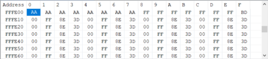

I use S12ZVML31 mcu. I've problem. FSEC register is not correctly loaded from configuration field after reset in my application.
I use this code:
volatile const unsigned char flash_array[] @0xFFFE00 = {0xAA,0xAA,0xAA,0xAA,0xAA,0xAA,0xAA,0xAA,0xFF,0xFF,0xFF,0xFF,0xFF,0xFF,0xFF,0xBD};
The following code is added in prm file
ENTRIES /* keep the following unreferenced variables */
/* OSEK: always allocate the vector table and all dependent objects */
//_vectab OsBuildNumber _OsOrtiStackStart _OsOrtiStart
flash_array;_vectab
END
but immediately after reset FSEC is still 0xFE.
I need secure my device but device is still unsecured.

when the MCU loads the code in debug mode then security is disabled (the security byte is programmed to unsecure state) and it is ensured the MCU will be accessible by BDM. Why? Because if the MCU is secured then there is no possibility to access the MCU except mass erase command from BDM.
Look int  attached file and png + doc files inside it which says more.
Moreover, if you use "normal"/standalone (no debugging is expected) programming of the S19 record......if the Srecord contains the security byte programmed to secure state or there is nothing in Srecord related to this address and the MCU is erased before programming then the device will be always secured because security byte contains erased value 0xFF.
You can understand from previous paragraph that normally (production and no backdoor key is required) the MCU is secured after masserase and program. So default status without touching security byte is secured without backdoor key. If we want to have the MCU unsecured in the field then we have to program the security byte to unsecure state.
Ladislav
