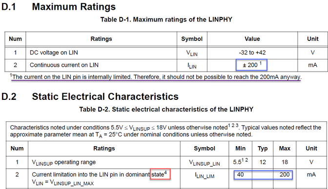

Can you please confirm at which current value LIN overcurrent Interrupt will be triggered ?
If LIN overcurrent interrupt is triggered, when current value is more than 200ma,but as seen in TRF s12ZVL Micro circuitry is limiting the current at 200ma, in that case as per our understanding we will never see the LIN overcurrent interrupt  get trigger.
we want to test the LIN Overcurrent Interrupt scenario without damaging the Micro.
Please suggest.
Thanks You in Advanced.
Charudatta
3,076件の閲覧回数
danielmartynek
Hello Charudatta,
Please have a look at the LIN PHY specification.
This is from the S12ZVL RM, rev.2.48
As you can see, the current is internally limited by the low side driver and it should not be possible to reach 200mA through the LIN pin.
The over-current interrupt asserts in the range of 40 - 200mA of I_LIN_LIM.
However, footnote 4 states the following:
That means that at higher temperature, the current might be limited below the I_LIN_LIM assert level.
