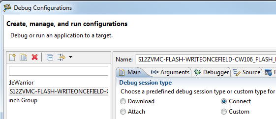

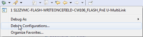

lama
the link you are mention is not a link even it looks like a link. Mea culpa, I have only copy/paste it. It is a path where the table is stored in the CodeWarrior help structure. The same you can see under my signature where I copy/past the page from the help.
The same you can find if you write, for example, "DW" into the search and it direct you to a debugger Shell Commands.
Probably answer on the second part is  already answered: https://community.nxp.com/thread/455729
If you want fre tool then it is enough to install special edition version of the CodeWarrior which has some limitations for compiler.

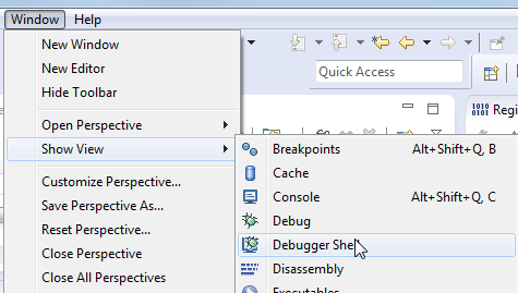

lama
The sources of information are:
- CodeWarrior for Microcontrollers V10.x > Targeting Microcontrollers > Microcontrollers V10.x Targeting Manual > CodeWarrior Command Line Debugging > Microcontrollers-Specific HIWARE Commands
(se list bellow)
- Tcl Reference Manual
- http://www.tcl.tk/
The device id is size of 8 bytes from 1F_C000 to 1F_C007. Of course you can read also other "reserved" field but they store  data the meaning is confidential, so I am sorry, I am not allowed to share. The same is valid for meaning of the device ID fields.
Ladislav

…. And press debug
In the debug enable “Debugger Shell”:
Before continuing please modify flash clock setup in both files to value suitable for programming on the basis of the oscclk you use. In the files search for lines
 Write into debugger shell command which runs the AAA_Read_Device_ID_And_OTPROM.cmd:
