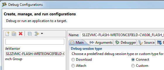

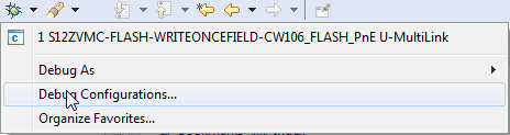

The sources of information are:
- CodeWarrior for Microcontrollers V10.x > Targeting Microcontrollers > Microcontrollers V10.x Targeting Manual > CodeWarrior Command Line Debugging > Microcontrollers-Specific HIWARE Commands
(se list bellow)
- Tcl Reference Manual
- http://www.tcl.tk/
The device id is size of 8 bytes from 1F_C000 to 1F_C007. Of course you can read also other "reserved" field but they store  data the meaning is confidential, so I am sorry, I am not allowed to share. The same is valid for meaning of the device ID fields.
Ladislav

The project which also present reading and writing program once field is not relevant but should be created for the device we want to play with. It is not required to be code (simple code, enough to use what is generated by wizard) loaded into the MCU’s memory. However, necessary is the debugger is connected to a memory. Because of this it is enough to set:
…. And press debug
In the debug enable “Debugger Shell”:
Before continuing please modify flash clock setup in both files to value suitable for programming on the basis of the oscclk you use. In the files search for lines
 Write into debugger shell command which runs the AAA_Read_Device_ID_And_OTPROM.cmd:
source "c:\D\CODING & SW\ECLIPSE\S12ZVMC-FLASH-WRITEONCEFIELD-CW106\AAA_Read_Device_ID_And_OTPROM.cmd"
(it is possible you have different path to the file…please change it)
