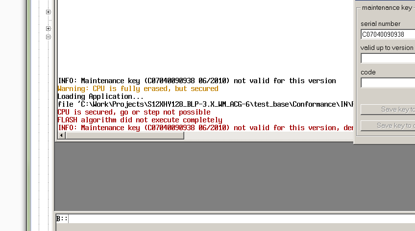

julieliu
Hello Daniel,
Thanks for you help and I have check the code.But still could not test yet as the board is go into secured mode.
you can see the error and warnings here.
seems I have erased some configuration field.
16 bytes (0x7F_FF00 - 0x7F_FF0F)
And this have effect on secure mode.
Do you have anyidea how to fix this issue.
thanks a lot.
br,
julie
10,593件の閲覧回数
danielmartynek
Hello Julie,
Please read S12(X) MCU Security.
The document also describes how to unsecure the MCU.
