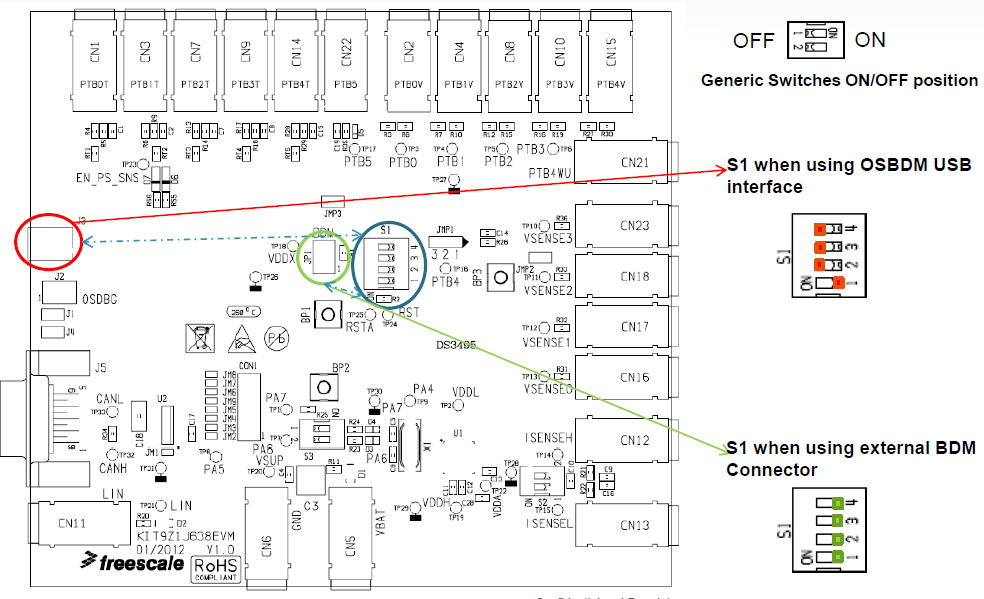

RadekS
Hi Kadir,
Please check S1 switch position.
There are two different settings for OSBDM and external debugger.
If you use OSBDM interface, please move switch 1 to the right side and switches 2, 3 and 4 to the left side.
The D6 and D7 have to glow.
I hope it helps you.
Radek
