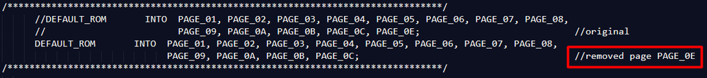

danielmartynek
Hello Julie,
S12G128 has different memory map. See attachments.
I’m not sure if you can use the code without any changes, I haven’t tested it.
We don’t have any Flash code ported on S12XHY128. The S12XS code was only for your reference.
Attached is an example ported on S12G240.
You should remove the pages that you use from the memory space in the linker file so that it would be used by compiler for code placement.
For example, the S12G240 code writes to 0x0E8000 - 0x0EBFFF so PAGE_0E is removed.
If you want to use 0x20000 - 0x2FFFF, remove pages PAGE_08 – 0B.
Do you read the flash with pointers? Or only using the memory window? Do you refresh it.
What is the status of error flags after a flash operations?
10,001 Views
julieliu
Hello Daniel,
Thanks a lot for your support now both S12G128 and S12XHY128 could work now.
S12XHY128 as well as S12G128 could write and erase with global address but read only with paged flash.
Now I could move forward with bootloader on this two boards.
Thanks again as I may also have issue with bootloader and will disturb you again.
