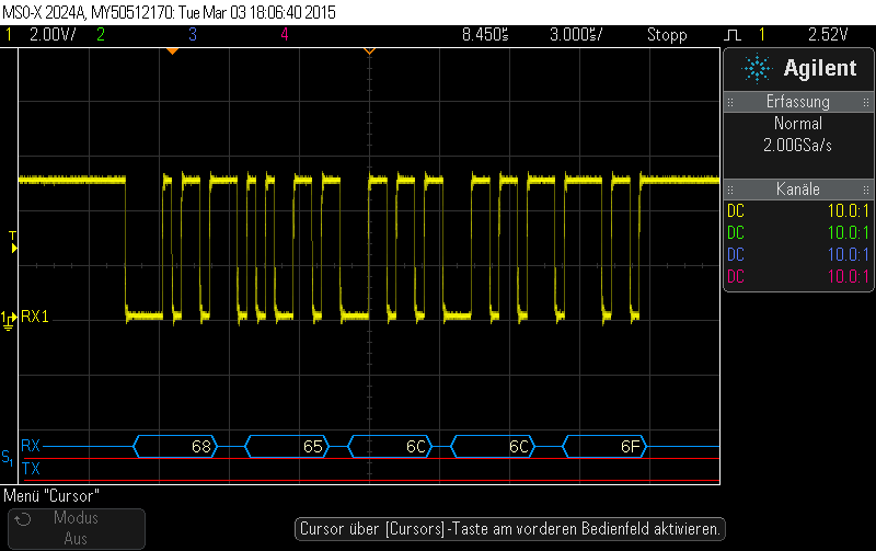

I use the S12XF Starterkit, which is powered by 5V internally and running from a 4MHz Crystal. The Bus Clock is set up to have 40MHz. The devboard exposes TXD, RXD and GND Pins to which I attached a 5V UART->USB adapter and connected it to a PC running Windows 8.1. There, a small C# application listens to any incoming bytes on the (virtual) COM port. The MCU Software generates a 75ms Real Time interrupt during which the data 0x68 0x65 0x6C 0x6C 0x6F (or "hello") is transmitted.

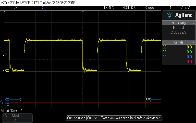

Of course it is likely that any combinations in between will function too. A prescaler of 0x0001, which should result in a 2.5Mbps datarate (if I'm informed correctly) was NOT successfull. This setting didn't cause any "DataReceived" Interrupt of the used "SerialPort" class. Nevertheless, on an oscilloscope, the waveform doesn't look so bad (well, you decide, see attached screenshot), so it might as well be a flaw of .NET. EDIT: As of now, I suspect the UART-USB Adapter to be the limiting factor and not .NET.
