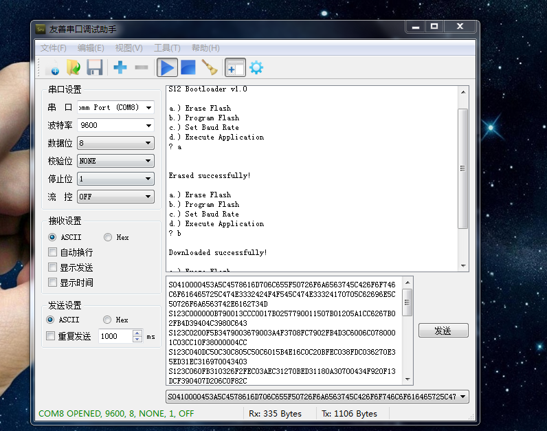

   Hello, I would like to add that.I direct the contents of the file“.s19” copy and paste into the PC serial communication assistant to send, interface display download success, but I run the program, the function is not normal, however I use BDM to download files“.s19”, run the program function is normal, I wonder whether my ".PRM" partition error? Or need to parse the file“.s19” and then send? What do I need to do, help me see, thank you very much!

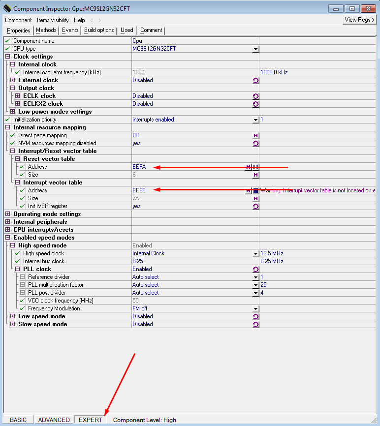

RadekS
Hi Jixiang,
1. There is a problem with interrupt vectors in your application.
The PE generated vector table at default vectors position 0xFF80~0xFFFF. This area is already used by Bootloader. You have to create vector table somewhere else in Flash or RAM.
Please switch PE CPU inspector into the Advanced or Expert mode and set addresses for Reset vector table (for example 0xEEFA) and Interrupt vector table (for example 0xEE80).
2. The s19 file must be converted by SRecCvt utility prior loading into MCU. That will manage that S records will have correct address format and that S-record size is exactly 32B (it simplifies parser in bootloader code – in Srec.c file).
3. The flow control of your PC terminal must be set for XON/XOFF mode. Unfortunately, I do not know PC terminal from your picture. You should select “b” and send s19 file content as a text file. Since programming needs some time, we must use flow control. Otherwise, receive buffer will overflow.
I hope it helps you.
Radek

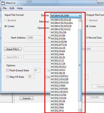

jixiangli
Dear Radek,
     Thank you for your patience!

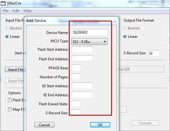

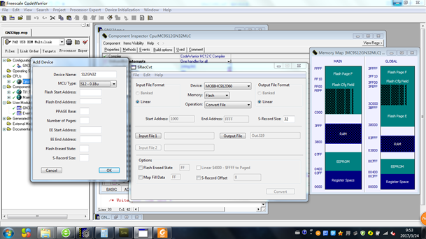

      I basically understand the process, thank you very much! But when I use the software "SRecCvt-GUI", found that there is no S12GN32 driver, I need to manually add this driver, in order to convert ".S19" this file, how do I need to add it? How do you fill out the address? Thank you very much. Here's my screenshot:

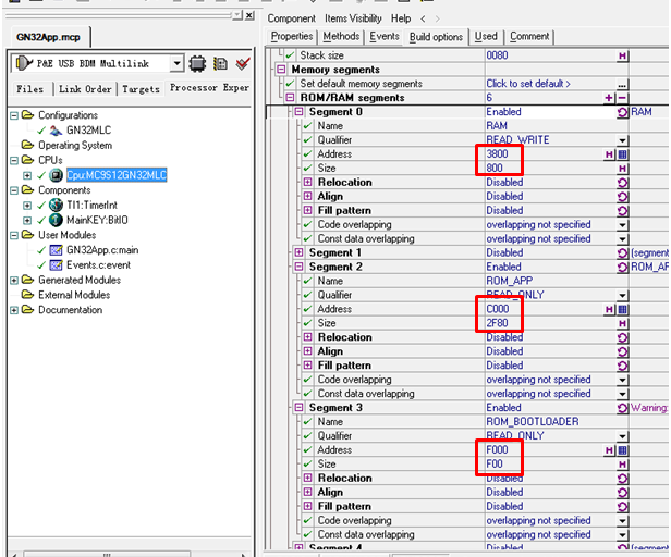

The following figure is my "PE" tool to configure the memory after the screenshot:
7,349 Views
RadekS
Hi Jixiang,
Thank you for more details. Now is clear what you mean by the S12GN32 driver.
I am sorry, that I forget to mention that.
Please select S12G128 for converting your s19 file.
Optionally you may add S12GN32 configuration by Add Device window or by simply adding a line into the DeviceInfo.Dat text file.
# Device          FlashStart  FlashEnd  PPAGEBase  NumPages  EEStart  EEEnd  FErasedState  SRecSize  Device Type
S12GN32,          8000,      BFFF,      E,         2,        0400,    07FF,  FF,             32,         s1218
Radek

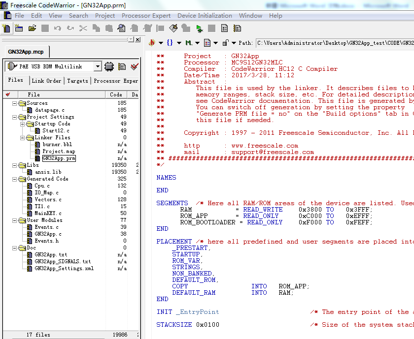

     I am still working BOOTLOADER a little problem, I would like to set up my own APP procedures and BOOTLOADER procedures for you, you help me analyze the problem where? Okay? Esteem it a favor!Attachment is my own establishment of the APP program and BootLoader program.

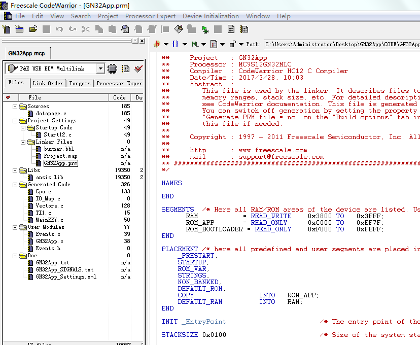

RadekS
Hi Jixiang,
The ROM area for Application and Bootloader must be separated. The meeting point between Application and Bootloader typically just Application start vector. So, Application does not know anything about the bootloader and vice versa.
From this point of view, the ROM_BOOTLOADER segment and ROM_F000 section in App linker file are quite useless information. Your App cannot operate at that part of flash used by Bootloader. But, this should not have any influence on functionality.
I can see the problem in App vectors:
The vector table in your APP (vectors.c) is defined at address 0xFF80U. That area is already occupied by the bootloader. Please configure proper address in PE per my previous recommendation:
https://community.nxp.com/thread/447344#comment-890099
If you already made that, you probably just forget to generate PE code.
Unfortunately, I made mistake in my recommendation. The Application start vector is defined in bootloader at address 0xEFFE. So, we have to either configure Reset vector table at address 0xEFFA or modify Start12.s file in bootloader and change line per your application settings:
AppResetVect:   equ     $effe ; here is stored reset vector of user application

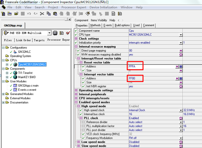

jixiangli
Dear Radek,

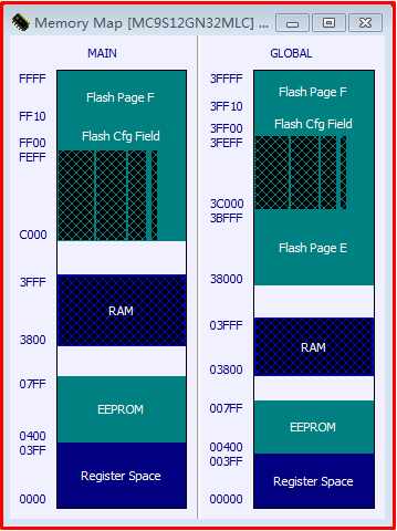

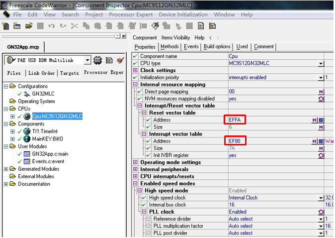

    Add a little more,I just directly modify the APP source code compiled through the BDM download to the microcontroller, can be successfully downloaded, but the program can not run, can not achieve the function, is it my ROM partition error? Thank you!
  But when I put the "reset vactor address" to 0xFFFA, "interrupt vactor address" to 0xFF80, and then re compiled, downloaded to the microcontroller through the BDM, to be able to run normally, the function is normal, table, table.
Figure:
Here's a bit of my personal understanding, is that right?
You can see the address 0XFF80, 0XFFFA no problem, they do not overlap!Do not know how to understand, thank you! Do you need any changes?
This is just my point of view, you follow your instructions to me, thank you very much! Best illustrated!
7,349 Views
RadekS
Hi Jixiang,
Note: doesn’t matter whether you select "effe" instead of "effa" in the bootloader. The S12(X) devices have three reset vectors (COP, CM, POR/LVR/Ext/…). The PE will create reset vector table at address 0xEFFA and fill it by three reset vector which all of them will point to the Application EntryPoint.
So, all 0xEFFA, 0xEFFC and 0xEFFE vectors have the same content (EntryPoint address).
It is OK when your application does not run when it is prepared for bootloader use and you load it by the debugger.
When you will load your application by the debugger, the default reset vectors (0xFFFA, 0xFFFC, and 0xFFFE) are erased and CPU will start to execute code from a wrong place.
When you load application by the bootloader, the default reset vectors (0xFFFA, 0xFFFC, and 0xFFFE) are filled by the bootloader and they point to Start12.s code. There is programmed rule for next execution of Bootloader or Application code.
Radek

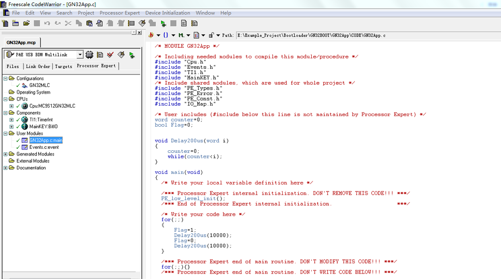

   Here is a screenshot of the APP program:
Attachment is my revised "BOOTLOADER" and "APP" source, you help me look at this right? If you have the wrong place, please take your screenshot to help me analyze the show, thanks!

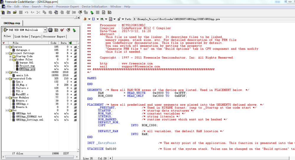

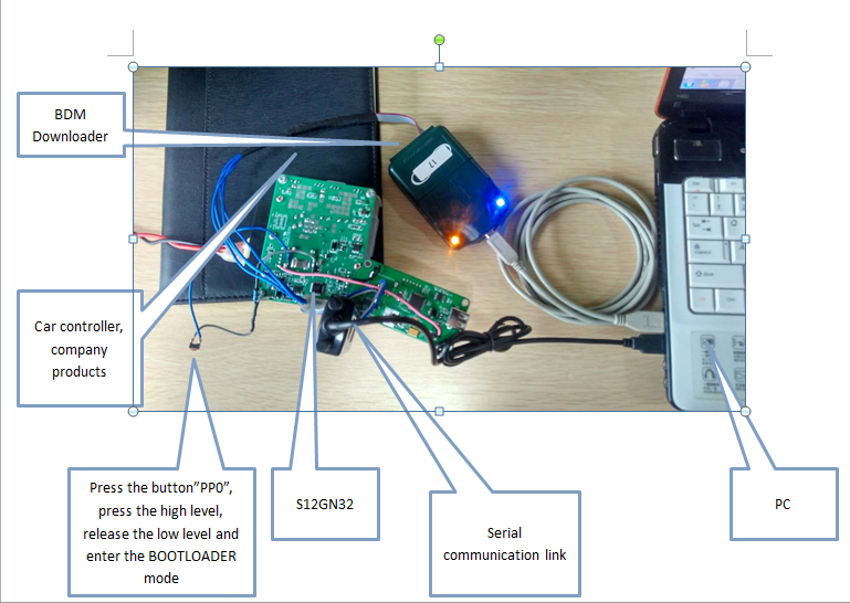

jixiangli
Dear Radek,

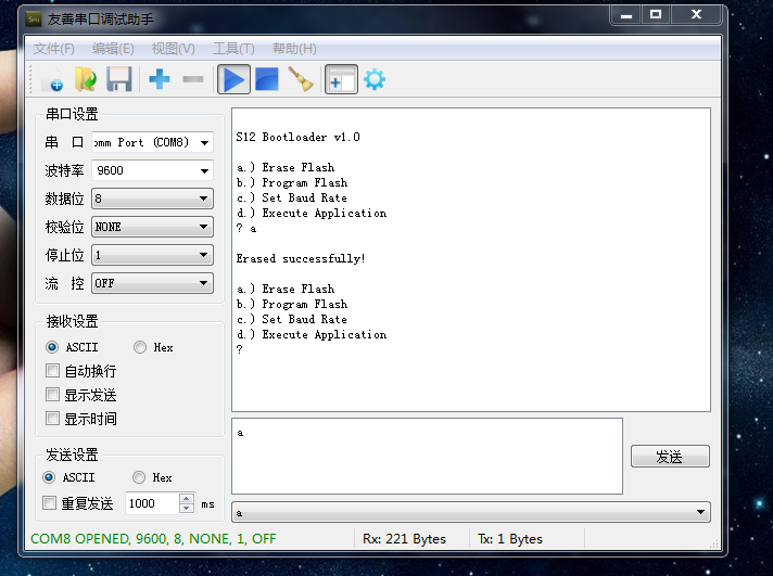

    Hello! I looked at the document, using the serial port to connect the circuit board and the computer, download the BOOTLOADER program has been able to communicate, the host computer can receive information, but also to erase success,As shown in the following figure:

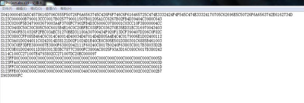

Then I used the "ProcessorExpert" tool to create a new project "GN32App", and then modified the memory address in the ".PRM" file, as shown in the documentation:
This is a compiled file“.s19”
I still do not understand a bit, the compiled file “.s19”,downloaded to the microcontroller through the BOOTLOADER, how to parse the file“.s19”,You gave me a software"SRecCvt-GUI", there is no driver on the S12GN32, I tried to add a, no success, can you help me add one?The main task is to compile the new project files “.s19”downloaded to the microcontroller through the BOOTLOADER, how to do, how to parse the file“.s19”, what is it? Thank you
