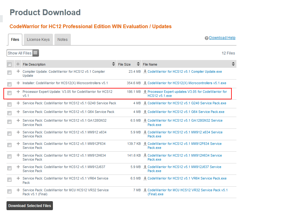

Hi, I'd like to run Device Initialization -> Initialize Device for a S12GA48, but CW tells me that it is not supported. May be CW12_V5_1_PE_V3_05_SP.exe can fix this problem but I don't find it on the web site.
Where can I find it?
Other possible solution:
I tried with a S12G48 and the device initialization is supported.
So can I run a Device initialization for a s12G48, then generate the code and then swap to a S12GA48 and compile?
Thank you in advance
Claudio

Hello Claudio.
I have reply you on the SR.
You can download CW12_V5_1_PE_V3_05_SP.exe here :
https://nxp.flexnetoperations.com/control/frse/download?agree=Accept&element=5901341
And about the Device initialization , i recommend you compare the two chip , after i check ,
these place are different :  internal RAm , EEPROM, and the ADC bit . And what detail content in your initialization ?
You can check the two chip here :
S12G Optimized MCU |16-bit MCUs|NXP
Hope it helps
Alice
