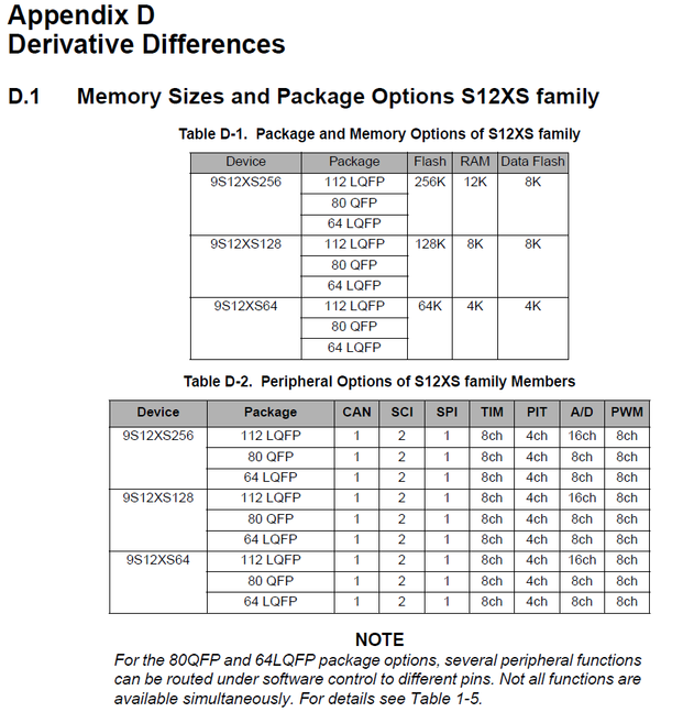

Can S9S12XS256J0CAE completely replace S9S12XS128J1CAE? Are the two just the difference in flash size?

Not only the Flash size but the SRAM too:
There are a few different specifications,
Table A-5. Thermal Package Characteristics (9S12XS256)
Table A-6. Thermal Package Characteristics (9S12XS128)

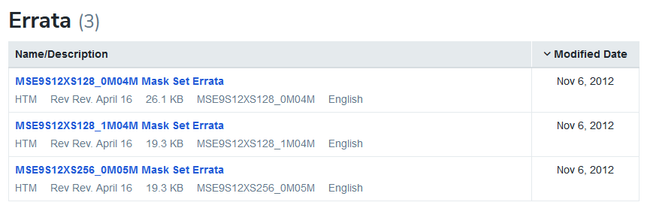

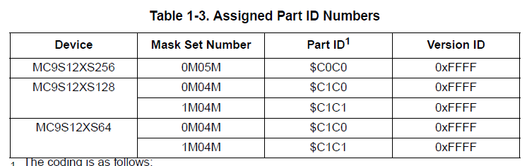

These two parts have different masks:
S9S12XS256J0CAE 0M05M
S9S12XS128J1CAE 1M04M
The RM specifies different part ID numbers:
Each mask revision has a different errata document:
