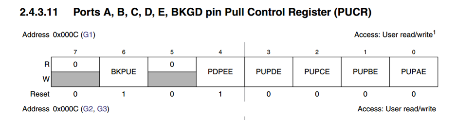

During the running of the program, the pull-up register of the port is rewritten, and the pull-up function of the port is opened after the rewriting. After checking the software did not operate this register, I would like to analyze from hardware, software, compiler, and what are the reasons for rewriting the register. How to locate the reason why the register is abnormally overwritten.

Another thing you should consider misaligned word write to MODE@0xB, which will overwrite PUCR@0xC as well. You need to setup at least two breakpoints. One for byte/word write to 0xC (PUCR) and another one for word write to 0xB. At least on S12XD DBG module looks for destination address, not for matching aligned word address. What I see on S12XD, when address is odd, both byte and misaligned word write to given odd address trigger breakpoint, but don’t trigger doing aligned word write. The question is what about instructions like EMACS? EMACS writing 32bits to 0x9..0xC will overwrite PUCR, but will it trigger breakpoint? We need to check. If not, then you should setup address range compare breakpoint and consider all write hits to 0x9..0xC as potential PUCR overwrite events.

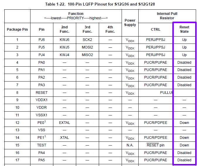

danielmartynek
Could you please specify the port?
What is the default pull configuration of the port? Please refer to the Pinout tables in the S12G RM.
What is the overwritten value of the corresponding Pull Device Enable Registers and Polarity Select Registers?
Thank you,
BR, Daniel
4,126 Views
song_xianming
The overwritten register is PUCR. Normally, its value is 0x50. After the exception is overwritten, its value is 0x5E. This phenomenon is sporadic. The probability of occurrence is relatively low. Debugging will not appear at all. We tested the software and there was no array overflow or pointer overflow. I am very surprised and have a headache with this question. Can not explain the reason with our customers.
