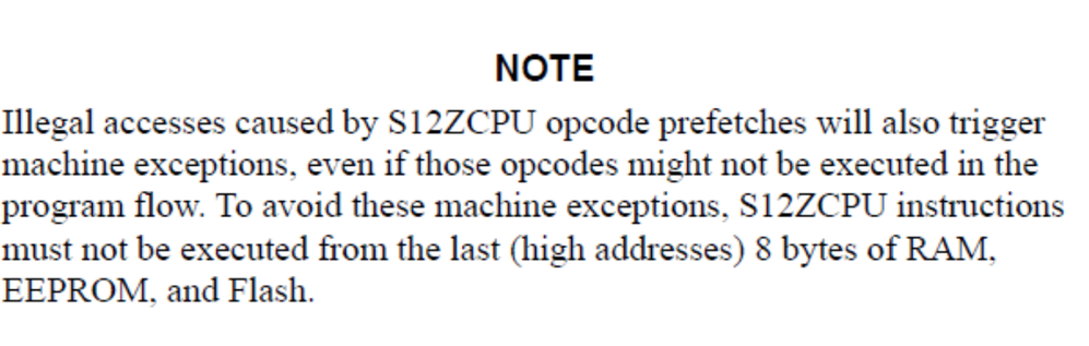

I have made some tests and when the handler is not defined the code jumps at the 0xFFFFFF address (defined by the erased machine exception vector) which triggers another machine exception.
See the note in the S12ZCPU RM below:
I hope it helps.
Diana

I understood the above obsevration
So, does it mean that recursive machine exception will be thrown(issued) and the execution of code will be stuck at this erased machine exception vector (0xFFFFFF)
