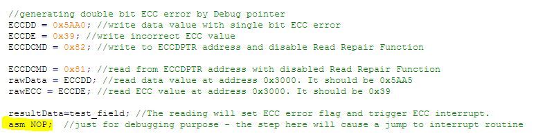

In Debug mode, When using "asm NOP" then iam able to reach Machine Exception ISR and able to Handle the ISR
but Iam not sure whether same thing is happening in Stand-Alone Mode(i.e Without Debugger). Because iam not able to See operations i have defined in Machine Exception ISR getting reflected.
Please guide on how to make sure that machine exception is reached in StandAlone also.

RadekS
Hi Pratibha,
I suppose that by Stand-Alone Mode you mean Normal mode (how it is defined in RM).
This example code for testing ECC on RAM may be tested only in the special mode (with a connected debugger). The reason is that ECCDCMD register may be written just in the special mode.
I think, that this is logical – you should be able to cause ECC issue for debugging purpose, but not in normal condition when MCU runs in a target environment. Keeping such option available also in normal mode is too dangerous.
I hope it helps you.
Radek

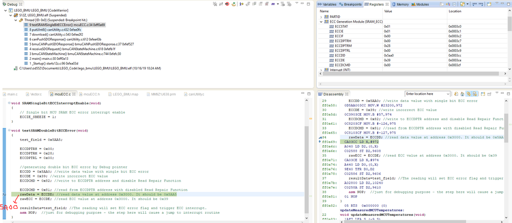

mihir_rajput
Hi Radek,
I have integrated the sample code provided in S12ZVC192-RAM_ECC-CW106 to test double bit RAM ECC errors.
However, I am not able to successfully test the functionality.
Looks like ECCDCMD register is not being written.
The step which says "rawData should read 0x5AA5" actually reads 0x5AA0.
Any ideas on what I could be missing?

RadekS
Hi Mihir,
you are right. There is a typo error in this comment. Thank you for notification. I will fix the example code.
It is obvious. We rewrote original 0x5AA5 value by the newer 0x5AA0 value. After that, we read it when Read Repair Function is disabled. So, we must read the new 0x5AA0 value.
Anyway, the double bit ECC error cannot be automatically fixed by the Read Repair Function.

mihir_rajput
Yes, I think the comments are incorrect for double bit error.
I was actually trying to understand why this piece of code wasn't resulting in a double bit ECC error.
The code just functions as usual. I was expecting to see a machine exception.
Looks like write to ECCDCMD register is not effective. There is a note in MM9Z1 datasheet saying that ECCDCMD register can only be written in special mode. I have no idea how to enter the special mode.
4,497 Views
RadekS
Hi Mihir,
Yes, that is correct. The ECCDCMD commands work only in a special mode for debugging purposes.
Therefore, the example code may be used only for simulating double bit ECC error, but not for invoking these errors in normal mode.
Anyway, the ECC check happened when we read from RAM/Flash/EEPROM. The ECCDCMD=0x81; is an exception from this statement. It will read data from RAM but without an ECC check. The ECC interrupt or machine exception occurs one clock after true RAM read, like command resultData = test_field;
The difference in modes:
Normal mode – we connect the power and MCU starts executing code from Flash. In short: produced devices in the field.
Special mode – we connect the power supply and BDM debugger. The debugger SW resets MCU into a special mode and MCU waits for commands from debugger SW (like step-in, run, …). In short: when we debug application (in an ideal case, before production start).
For more details, please check chapter 5.2.6.1 Chip configuration modes on page 53 of MM9Z1_638 RM.
Radek

mihir_rajput
Thanks, Radek. I was able to successfully trigger single and double bit ECC errors on RAM.
Your explanation about special mode was helpful.
