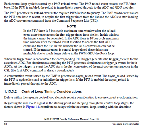

Hello pratibhasurabhi,
This specification in the RM has changed.
Below is a snippet from RM rev 1.5.
It seems that the demo hasn’t been updated.
BR, Daniel

pratibhasurabhi
Contributor V
Hi Daniel,
Thanks for the quick reply.
The note I have mentioned above is from RM Rev 2.13. We are referring the latest version.
The note you have mentioned is from Rev 1.5.
Please let me know, which note should be used.
Thanks in advance.
1,228件の閲覧回数
danielmartynek
Hi Pratibha,
Please use the latest version of the RM, rev 2.13.
Thank you,
BR, Daniel
