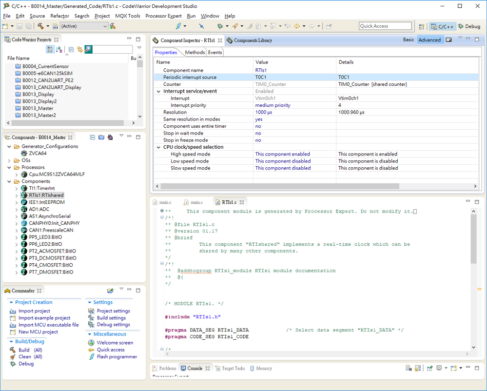

We are using S12ZVCA & Processor Expert(CodeWarrior 11.0.1). And we are setting RSIs1 to trigger a ISR per 1ms.
How to increase variable "i" per 1ms in main()?
main()
   uint16_t   i;
   i++;         // when ISR(RTIs1_Interrupt) is trigger

I have been add code "i++;" to ISR(RTIs1_Interrupt). But "i++;" disappear when i regenerate the PROCESSOR EXPERT CODE.
Do you have any recommend?

Hi Aaron,
I would like to apologize for the delay.
I assume you are using RTIshared component.
Can you share your settings of this component?
When I generate code with default settings I can see that there is a counter
RTIs1_Cnt++; in the interrupt routine. I assume you can use it instead of your own variable "i".

Hi Diana,
We are using RTIshared component. But I don't know why our ISR(RTIs1_Interrupt) is different from yours.

Hello Aaron,
I attached my project with the same settings as yours in CW 11.1. Could you please check it?
I hope it helps.
