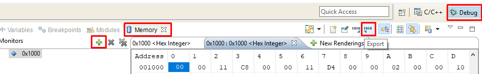

I now use BootLoader to burn the APP program to the MCU, but I need to burn the BootLoader and then burn the APP program. I have the tool to synthesize the BootLoader and the APP, but I can't ensure that the composition is correct, so I want to read it. Take the Flash in the MCU for comparison. The tools I have now are MULTILINK UNIVERSAL and CYCLONE UNIVERSAL.

The CodeWarrior provides the possibility to export memory into Srecord file from the Memory window.
The Memory window can be found in the debug view and can be shown by menu Window -> Show View -> Memory.
By "green plus" button can be chosen an address and by Export button you can choose the required address range.
I believe it helps.
