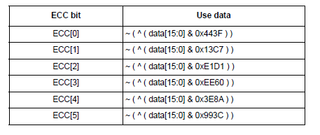

janiosimon
Hello Radek,
i would like to understand the ECC calculation. In MC9S12ZVLRM.pdf is this table:
if i understand correctly then the ECC can be calculated as:
ecc[0] = data & 0x443F;
ecc[1] = data & 0x13C7;
ecc[2] = data & 0xE1D1;
ecc[3] = data & 0xEE60;
ecc[4] = data & 0x3E8A;
ecc[5] = data & 0x993C;
for (j=0;j<6;j++)
   tmp = 0;
   for (i=0;i<16;i++)
      tmp ^= ((ecc[j] >> i) & 0x01);
ecc[j] = tmp;
for (j=0;j<6;j++)
   eccFinal |= ecc[j] << j;
eccFinal ~= eccFinal;
I would expect that eccFinal will have this results:
data       ECC (NXP)      eccFinal
FF00      36                     2D
FF04      20                     0E
FFF4      20                     1A
FFFB      29                     1C
Please correct me if my interpretation is wrong.
Thank you for answer.
Jan
11,898 Views
RadekS
Hello Jan,
just a small misunderstanding.
The ECC bit table in RM is for SRAM. The SRAM allows reading/write ECC in debug mode.
The EEPROM uses a different table for ECC checksum calculation.
This table is confidential. The EEPROM/PFLASH ECC cannot be directly read by the user.
I hope it helps you.
Radek

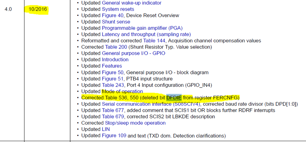

mihir_rajput
Is there a reason why DFDIE was deleted?
