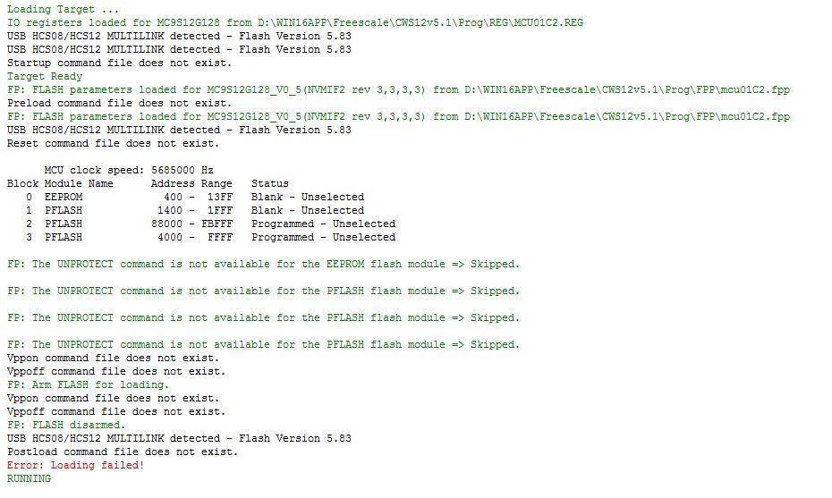

Hello guys,
I've been requested to flash (using Hiwave / HC12MultilinkCyclonePro) a program for S12G128.
I've got one project for which Flash starts at 0x88000 and which can be flashed without any problem; and a .mot file (I don't have the project only the file) with a start @ at 0x20000.
Whatever I do (reconfiguring Memory Map), flash always fails "No memory at this address".
People whom provided me the mot file are using another system (IC3000) and says no problem to flash.
Does anyone have an idea/advice/solution ? Thanks in advance.

Hi Andre,
Problem is just with address format.
CodeWarrior debugger (hiwave.exe) could work only with images where addresses are in banked (logical) format (PPAGE+address in 64kB address space).
Your .mot file contains addresses in linear (global) format.
You need convert this file into banked format for use with hiwave.exe.
Please download SRecCvt tool:
http://www.freescale.com/webapp/sps/download/license.jsp?colCode=SRECCVTSW
and run SRecCvt-GUI.exe
Select S12G240 device, input file format Linear, your *.mot file as input file 1, output file format Banked.
If you don’t select output file, result will be stored as Out.s19 at the same directory as input file.
I hope it helps you.

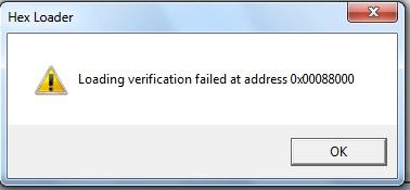

andreducroz
Hello Radek,
First, your downloaded file made my PC crashed.
After a retry, it worked. I transformed the file in .s19 and flashed it using hiwave but
And also, even if I didn't checked the "automatic Run after load" it seems it did and I wasn't able to to stop it except by switching off the power.
After an unsecure; I read memory and I wasn't able to see any code in.
Any advice ?

RadekS
Hi Andre,
It seems that there are some problems with paths.
Please create new empty project for S12G128 and load it into MCU.
If loading will be not work due to security, please unsecure it by Code Warior debugger menu ->MultilinkCyclonePro->Unsecure…
If not work you can use unsecure12 from P&E:
http://www.pemicro.com/downloads/download_file.cfm?download_id=16
Unsecure_12 Help Files:
http://www.pemicro.com/downloads/download_file.cfm?download_id=14
Note: For downloading is necessary registration.
After that you could use debugger for loading customer code. However prior that please additionally check s19 file:
If this file contains any data at address 0xFFFF08..0xFFFF0F(0xFF08..0xFF0F for S1 records) except unsecure byte 0xFE at address 0xFF0F, please add command “FLASH NOUNSECURE” into preload command file (P&E_Multilink_USB_Preload.cmd if you use PE Multilink).
This will cause that security byte will be not programmed prior loading code into flash.
For more information about flash security, please look at document:
https://community.freescale.com/docs/DOC-93803
If s19 file contains any data at address 0xFF0E (FOPT register), please add command “wb 0x03c 0x00 //disable cop” into reset command file (P&E_Multilink_USB_Reset.cmd if you use PE Multilink).
This will cause that watchdog will be disabled after every reset caused by debugger.
