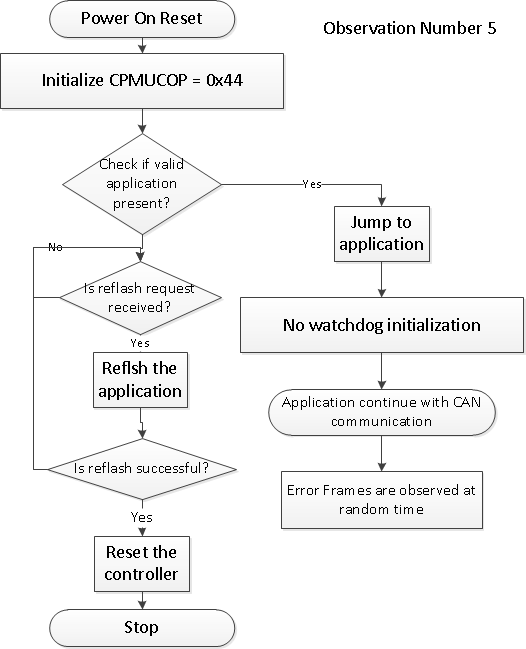

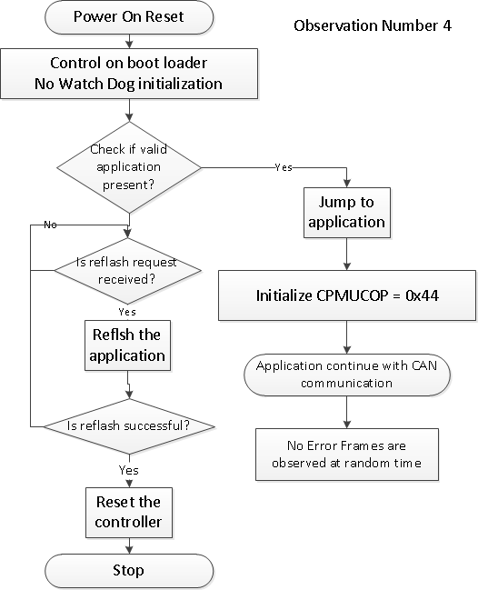

ganeshvijayakum
Hi Radek,
I really appreciate for your reply.
We are jumping to the application from bootloader when a valid application flag is present, and re-flashing supported using bootloader(CAN is enabled in bootloader).
I have monitored the COP ISR by toggling a test pin but no watchdog reset is observed(None of the reset is being issued).
For your information I am not bothered about the error frames received while jumping from bootloader to application.
I am bothered about the error frames while CAN is running after successful re-flashing of the module.
Please look into the following observations mentioned,
      1) When I flash only application and run the module only with application, No error frames are observed on the bus.
      2) When I flash only bootloader and run the module only with bootloader, No error frames are observed on the bus.
      3) When I flash bootloader and re-flash the application, error frames are observed on the bus at random period of time.
      4) When I flash bootloader(commented watchdog initialization) and re-flash the application, No error frames are                       observed on the bus.
      5) When I flash bootloader and re-flash the application( with watchdog commented), error frames are observed on the           bus.
To make you clearly understand please look into the pictures below code flow for steps mentioned above,
So, I would like to know why the watchdog initialization is causing the CAN error frames.
Please let me know your comments.
Thanks in advance,
Ganesh Vijaya Kumar P

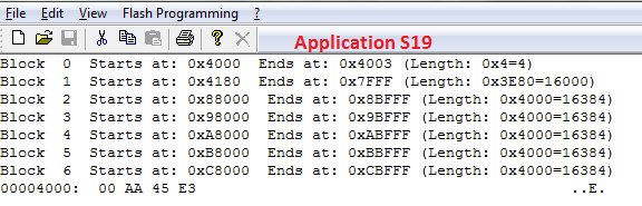

RadekS
 Hi Ganesh,
Thank you for more details.
According to your description, the error frames are observed on the bus only when both bootloader and application are loaded into flash and when bootloader contains COP initialization to 0x44.
From my point of view it rather looks like some issue in memory range overlaps:
1. The bootloader with COP init code is probably longer. Could you please check map/s19 files whether bootloader and application do not use the same flash area?
Optionally you may try to replace COP init code in bootloader by few asm NOP; commands to keep the same code length and watch the application behavior.
2. I suppose that there is memory overlapping in the case of RAM. Your application may use some uninitialized variable which causes that 0x44 is sent over CAN instead their default value. Please check default values of application variables after application start.
3. There might be some pointer in the application which points to bootloader flash area. Please ensure whether you reference correct data.
Unfortunately, you didn’t specify your jump into the application. Is it through MCU reset like in AN4258 bootloader case or you just use JMP/JSR/CALL commands?
In the second case, two initialization of COP watchdog (in bootloader and in the application) have no sense. The appropriate bits in CPMUCOP register may be written just once in normal mode.
Are you sure that you jump to application’s _Startup() function with stack and RAM variables initialization?
Ans: I have compared the .s19 file for both the application and bootloader and please look into the below pictures,
Looks like blocak 0 in bootloader and application are overlapped. Is that what you are expecting?
Please let me know if this may effect the micro controller functionality.
Yes, I am using JSR to jump from bootloader to application and it jump to the _Startup() routine of the application code, in which we initialize stack and RAM.
I will be very happy to see your reply again...:-)
Thanks for your support.
Ganesh Vijaya Kumar P.
6,938 Views
ganeshvijayakum
I am sorry the block 0 which is present in the bootloader and application s19 file is used to check if valid apoplication present.
It seems problem is with something else...
