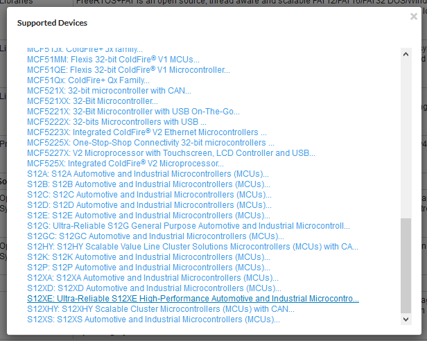

danielmartynek
S12XE is supported by FreeRTOS
NXP - Partner Profile Information

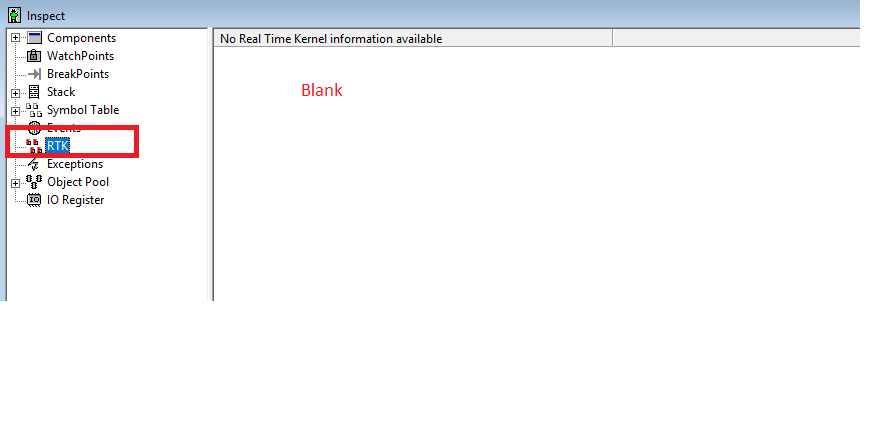

Eric_t
Hi Daniel
Free rtos supports HCS12 & S12X but what about codewarrior?
Does codewarrior has freertos awareness?
As you can see the RTK information is blank.

Eric_t
Hi Daniel
The article refers to compiler & processor expert.
Unfortunately there is no reference about the debugger.
Without any information about the tasks, the rtos is almost useless.
On the other hand I cannot believe that the most common rtos is not supported by the debugger.
So, does anyone really use freertos on HCS12 or S12X controllers?
3,077 Views
BlackNight
Hi Eric,
which debugger are you using? I assume HIWAVE with CodeWarrior classic 5.1? At least this is what I'm using.
There is no kernel awareness in that HIWAVE debugger for FreeRTOS.
Thinkinig about alternatives: The Lauterbach debugger comes to my mind which includes dedicated views for FreeRTOS, in case you are not aware of it.
