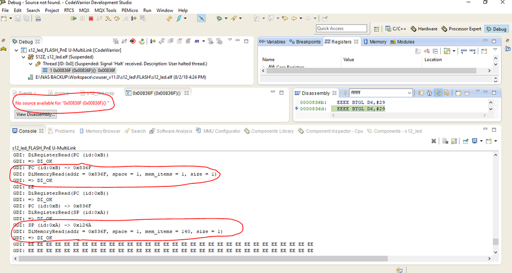

I am using s12zvml31 controller. When i tried to debug my software the machine exception occurs and i saw the datasheets and checked the registers mmcec and mmccc,
Error code register
Bit Field Values:
ITR bits[ 15:12 ] = 1 S12ZCPU
TGT bits[ 11:8 ] = 1
ACC bits[ 7:4 ] = 1 Opcode fetch
ERR bits[ 3:0 ] = 1 Access to an ilegal address range
Captured S12ZCPU Condition Code Register
Bit Field Values:
CPUU bits[ 15:15 ] = 0
bits[ 14:14 ] = 0
bits[ 13:13 ] = 0
bits[ 12:12 ] = 0
bits[ 11:11 ] = 0
bits[ 10:10 ] = 0
bits[ 9:9 ] = 0
bits[ 8:8 ] = 0
bits[ 7:7 ] = 0
CPUX bits[ 6:6 ] = 1
bits[ 5:5 ] = 0
CPUI bits[ 4:4 ] = 1
bits[ 3:3 ] = 0
bits[ 2:2 ] = 0
bits[ 1:1 ] = 0
bits[ 0:0 ] = 0
I have tried the exception handler by writing CPMUARMCOP register to reset the controller and Im not writing any instruction at last 8 bytes of RAM, ROM. Am I missing anything?
Please help me to found out.

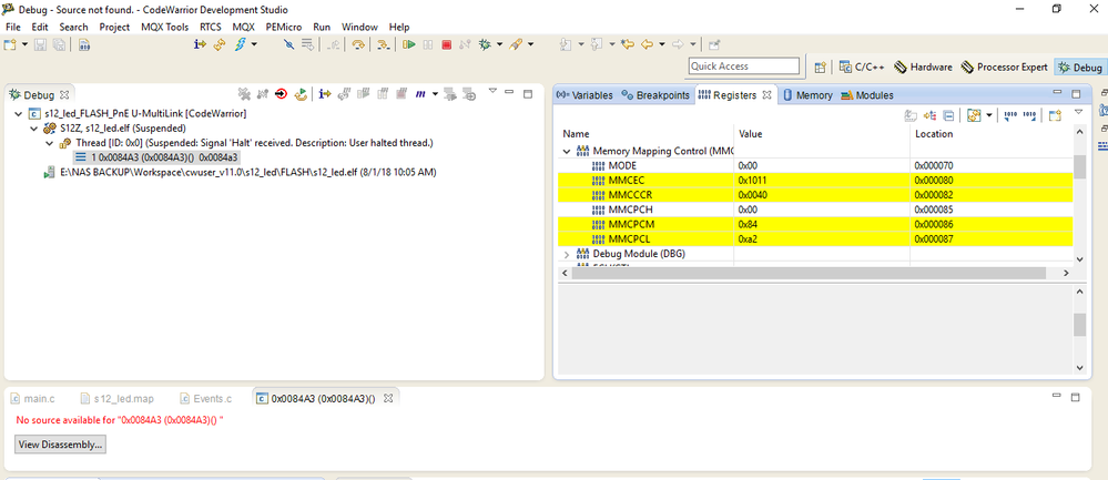

kaarthichandras
Thanks Edward,
I checked the address that pointed by MMCPC register and that address points to non accessible memory of controller and cross checked the .map file, there is no such address.

kaarthichandras
Thanks Edward,
I attached a screenshot of register value when I get exception and check the MMCPC register, it is actually a non-accessible memory.
