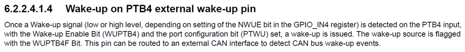

  2. enable CAN wakeup using PTB4 B_PCR_WUEH_WUPTB4 = 1
    • PTB4 is already configured in GPIOInit()

1. A wakeup due to CAN communication requires that the CAN PHY is powered. For the NXP hardware platforms this means that the MM9Z1_638 is in STOP mode which keeps the VDDX (5V) powered on whilst in low power mode. The SW snippet above indicates you are using STOP mode.
2. The wakeup is using the PTB4 pin wakeup.
  • On the RD91ZJ638-12V-C board this is already configured from the HW point of view.
  • On the "EVB" you have to configure it according to the SW HTML documentation coming with the SW (folder docu). I also attached the relevant pages as pdf.

danielmartynek
Hello @baji,
I see that source of the wakeup in your code is PTB4.
Please refer to the datasheet.
Please make sure it is configured as explained above before the MCU goes to the Stop mode.
And apply a wakeup signal to PTB4 according to the configuration.
Thank you,
BR, Daniel
