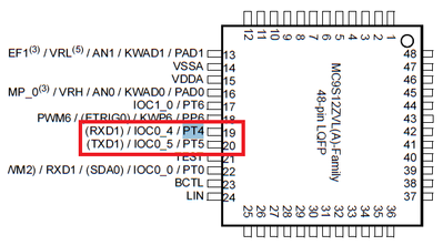

Which ports do you use to switch the transistors?
2,695 次查看
JoeZhou01
GPIO used, see details as below:
2,683 次查看
danielmartynek
Hi @JoeZhou01,
I don't see any issue in the MCU itself.
Since you have the external pull-down resistors there, the pins are not floating out-of-reset.
The signal that you see on VBAT/VSUP is generated by the motor.
And that is an application issue which out of scope of our support.
If there was no motor, the VSUP voltage would slowly fall towards the ground (depending on the BULK capacitor and the consumption of the MCU) and VDDX would follow.
