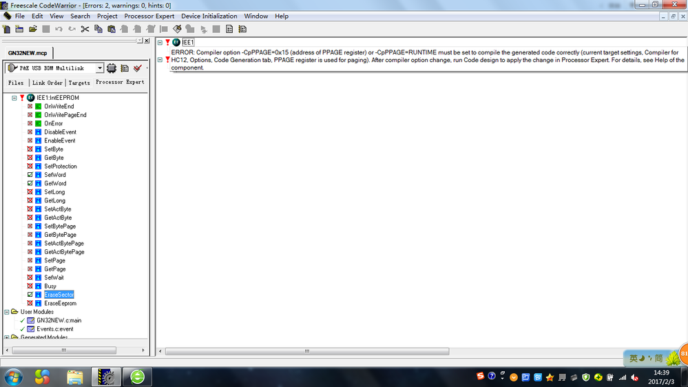

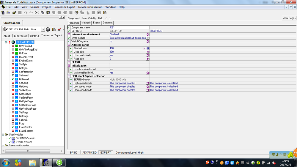

I recently in the use of MC9S12GN32MLC chip, using this chip to do a car controller, due to the program upgrade, need to use the EEPROM module. I use the Processor Expert program, the following is my specific configuration, the EEPROM module shows the red exclamation mark, I put the wrong paste, please help me analyze the fault, thank you very much!!!

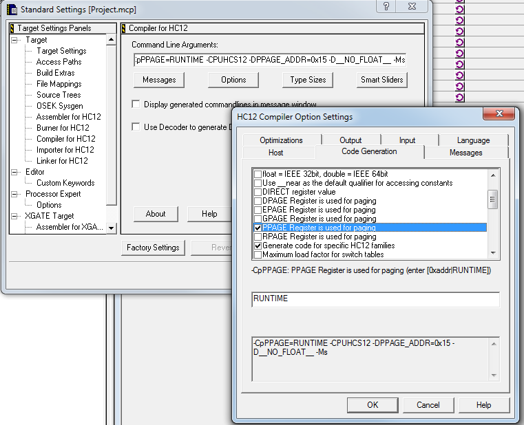

Alt F7 -> Compiler for HCS12 -> Options -> Code Generation -> match PPAGE Register used for paging -> Write  RUNTIME into an empty cell below. -> OK -> Apply

jixiangli
Thank you very much for your reply, help me to solve the problem, hope to make a friend, thank you!
