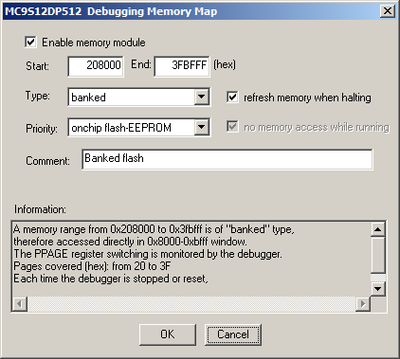

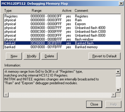

I am a little bit confused. The C in the examples is like flow chart in the form I provide it. Moreover, you can use disassemble function. Mouse right button click at C code. Plus you can compare Figure 19-26. Example Program Command Flow from the data sheet with code. Yu can also use simulator for these MCUs or just load my example int the MCU you have and step it. Important note....Do not visualize in memory window of debugger the flash address which is currently E/W. Why? Because BDM reads it and it is also reading while writing. For tests, it is better to read the written word back to some variable....or you can move memory window up and down. Next good note is to set for flash "refresh memory when halting" in the debugger
select correct flash blocks...this is only example
and match "refresh memory when halting"
Of course it is suitable if you also think about critical section and execution part of the code out of the flash…already described.
