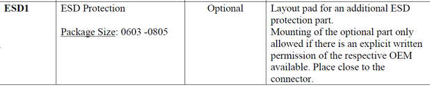

    After testing, we found that TVS caused this problem. If we remove TVS, the BCI test is OK. However, removing TVS will cause LIN Timeout error in other experiments, such as ESD. Do you have any good suggestions

There is too little information, and this is out of scope of our technical support.anyway as this is an application issue.
ESD1 protection at LIN is optional (AN5207 S12ZVM HWDG)
