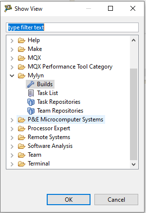

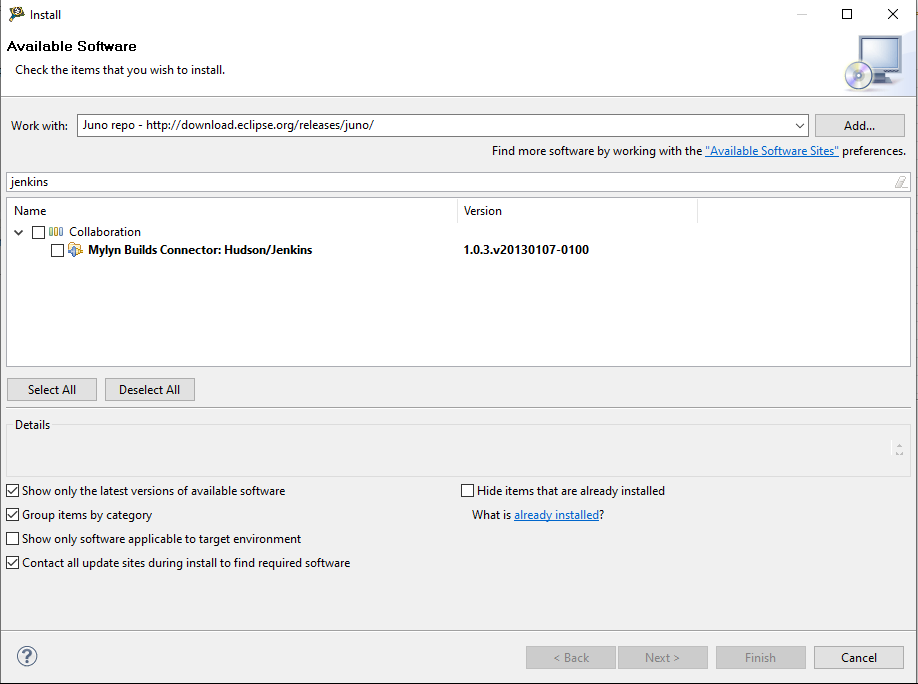

I have no personal experiences with Jenkins building, but you can probably start with installation of plugin.
1) Go to menu Help - > Install New Software. Add and select Juno repository into updater:
At the end of installation you need to restart CodeWarrior and new View is now available (menu Window-> Show View -> others -> Builds.

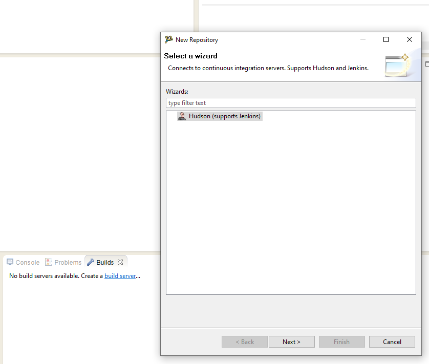

In this view you should be able to connect to Jenkins build server:
Unfortunatelly I don't have running Jenkins server installed so cannot test the connection.

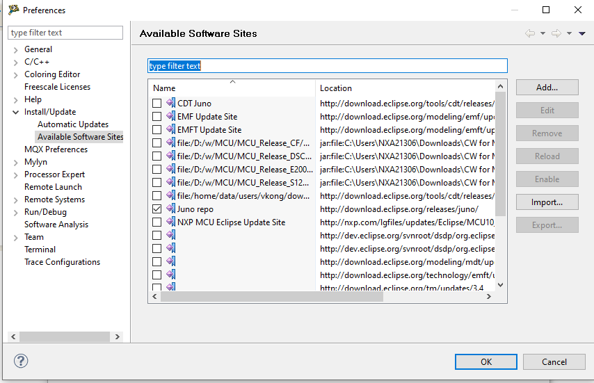

Thanks for the reply i was trying to install the suggested plugin from your suggested steps unfortunately it is showing error and plugin is not getting installed.
i am attaching the screenshot please have a look on it and suggest how to fix that.

Hi Stanislav,
Now i have successfully installed the plugin through the steps that you have mentioned above.

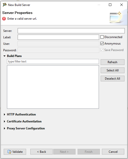

Still i am unable to connect jenkins with the plugin.
Can you please show me the steps by which jenkins build plugin can be integrated with jenkins.
