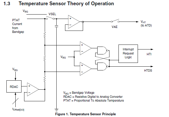

Generally, how could it be that in family reference manual, high temperature interrupt assert and disassert tolerance is defined and tolerance for VREG temperature sensor output voltage at 150C is not defined? According to AN3624, ihigh temperature interrupt assert and disassert is done as a result of comparison between VBG (Constant value) and VREG temperature sensor output voltage. See figure below. Therefore, high temperature interrupt asser/disassert and VREG temperature sensor (uncalibrated) should actually have the same tolerance...

The reference manual (Chapter A.1.8) describes relation between junction temperature, ambient temperature, total chip power dissipation and package thermal resistance. As per AN3624 (Chapter 2.2), the calibration of this sensor should be done based on that equation. Surface temperature is not ambient/junction temperature.
The device must be allowed time to stabilize at ambient temperature using an oven or a thermostream. Then based on the equation the junction temperature can be calculated.
I don’t know the power dissipation so I cannot tell if the difference is too high.
Please measure the bandgap output voltage, it is not exactly a constant, it should be in range 1.14; 1.20; 1.28V (Table B-1).
