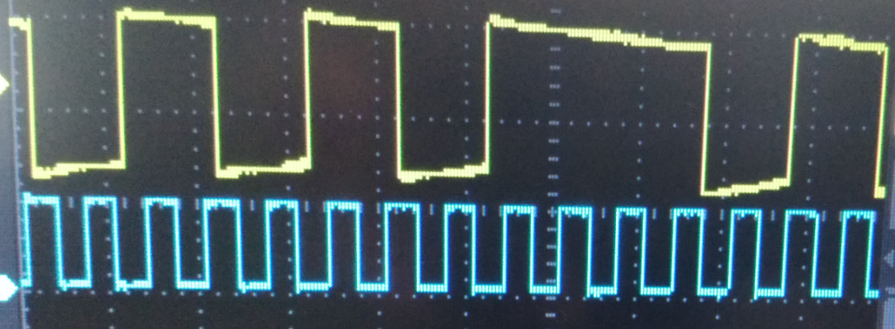

I use IC to capture an input square wave, and then generate my output square wave by PWM model .
The frequency of my output is several times of the imput wave, such as 2 times, 5 times, so much as
60 times. I use IC to detect the rising edge and the trailing edge to get the pulse width, according this to determine the period of the PWM.
But I found when my input wave frequency change, the output can't be change together with the input
wave, even the times of the frequency also can't be contain.
Whether I need to close my PWM at the end of PWM period and enable it at the beginning of the
wave edge. How can I make my output wave change following the input wave change.
My programme, the input and output wave are attached.

so is your problem that change of output PWM frequency happens much later than the change of input frequency? It is because you made your IC sensitive to rising edges only, TCTL4 =1 , EDG0B:EDG0A = 01. And this is what you see on oscillogram: PWM frequency changes soon after rising input edge, when there's a change in time difference between two adjacent rising input edges.

Hi Meng,
  1. PWMCNT01 contains PWMCNT0 and PWMCNT1 register, therefore, you should write a 16bit number.
  2. Your calculations are still confusing for me.
signalf=delaytime/1000*4;
PWMPER01=signalf*1000/10;
This code generates the same result for 0~999, 1000~1999, 2000~2999,… delaytime.
So, there is a chance that both 30ms and 50ms input signal generates the same PWM period.
Is it correct, that you want PWM period = high or low time of input signal/2.5?
In that case please don’t use that division by 1000.
The code:
signalf=delaytime*4;
PWMPER01=signalf/10;
should give you result without losing accuracy. Be aware, that maximum delaytime must be smaller than 16383 otherwise you have to change signalf type to unsigned long and retype delaytime value to unsigned long prior signalf calculation. For example:
unsigned long signalf;
signalf=((unsigned long) delaytime) * 4;
PWMPER01=(unsigned int) (signalf/10);
I hope it helps you.

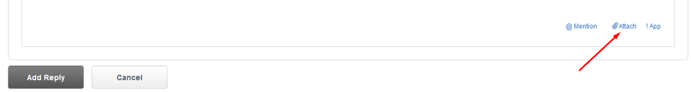

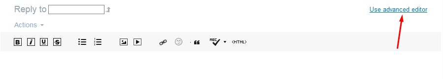

You may attach code here when you switch editor into advanced mode:
and then click on Attach link:
If you want to share something which is not public, please create a ticket:
How to submit a new question for NXP Support
As last option, you may send it to me at [email protected].

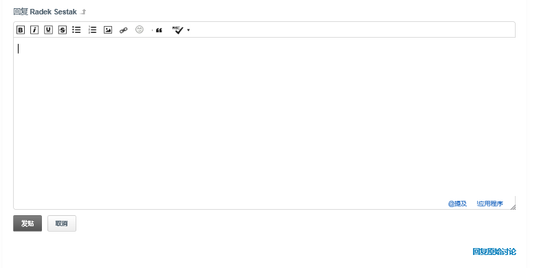

I can't fine the buttons ''use advanced editor' and "attach" on my reply page https://community.nxp.com/inbox .
My page is as follow:
I have already sent you an email, I don't know whether you have received it, I haven't received your reply.
This address is right ?[email protected][email protected]
