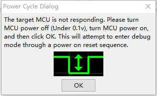

There is a problem when I try to debug VLG-MC9S12ZVC Board。
I have tried to restart the power ,but the problem still exists。

This dialog indicate then the debugger doesn't establish connection.
Did you check debugger connection by BDM connector (if you use external debugger interface) or power supply - 12V?  So, please check reset pin levels and voltage levels.
