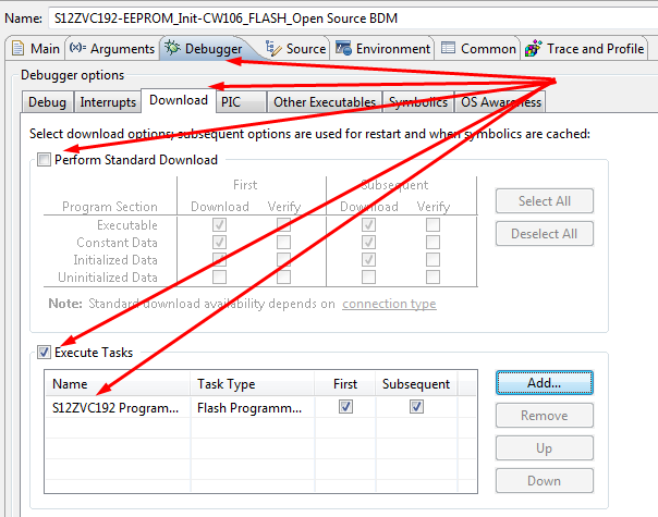

I have many version of elf file. How to verify those code with MCU?
And, how to security MCU flash (unable to read)?
Aaron

Hi Aaron,
If I understood correctly, you want to process how to load elf file into MCU without original project.
Correct?
The simplest way will be creating new project for target MCU derivative.
After that, please open “Target Task” window by menu-Window-Show view-Other-Debug-Target Tasks
Now, you may create new Target Task

Optionally you may configure Project Debug Configuration, uncheck Perform Standard Download and add your Task into the list. In this case, the you may start debug session the same was as for standard Project.
