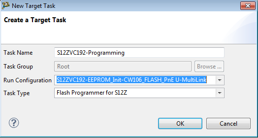

RadekS
Hi Aaron,
If I understood correctly, you want to process how to load elf file into MCU without original project.
Correct?

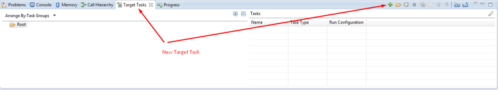

The simplest way will be creating new project for target MCU derivative.
After that, please open “Target Task” window by menu-Window-Show view-Other-Debug-Target Tasks
Now, you may create new Target Task
Please enter name and select configuration (The configuration was created with our new project). As Task type, select Flash Programmer for S12Z.

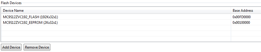

Please add Flash Device – separately for Flash and EEPROM (if necessary)

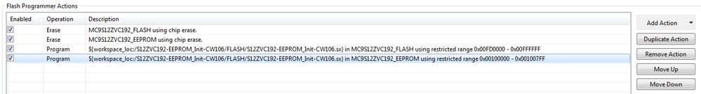

Add Action – Erase/Blank check
I would like to recommend erase whole block. If you program also EEPROM, erase also EEPROM block

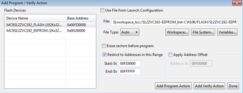

Add Action – Program/Verify
Select your elf file and check Restrict to Addresses in this Range if you program Flash and EEPROM separately
You may add also verify commands or enable/disable commends by check buttons on left side.
