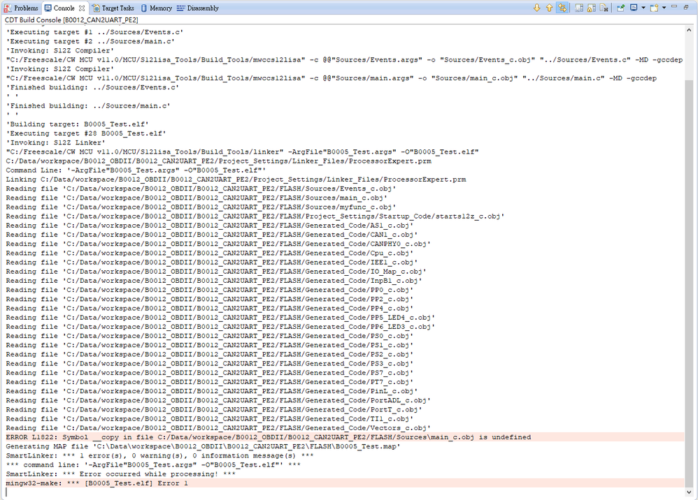

Hi Diana,
Thanks for you quick reply. We got the link error as follow:
myfunc.c
#include "myfunc.h"
unsigned char TI1_CountUp;
unsigned char foo(void)
   return TI1_CountUp;
myfunc.h
#ifndef MYFUNC_H_
#define MYFUNC_H_
extern unsigned char TI1_CountUp;
unsigned char foo(void);
#endif /* MYFUNC_H_ */

How to resolve the issue:
ERROR L1822: Symbol __copy in file C:/....../FLASH/Sources\main_c.obj is undefined
