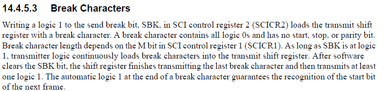

We should toggle with SBK bit for transmitting break signal. For example:
SCI0CR2_SBK = 1; //START TO SEND
SCI0CR2_SBK = 0; //STOP SENDING BREAK
or
SCI0CR2 |= 0x01;
SCI0CR2 &= ~0x01;
A break character contains all logic 0s and has no start, stop, or parity bit. As long as SBK is at logic 1, transmitter logic continuously loads break characters into the transmit shift register. After software clears the SBK bit, the shift register finishes transmitting the last break character and then transmits at least one logic 1. The automatic logic 1 at the end of a break character guarantees the recognition of the start bit of the next frame.

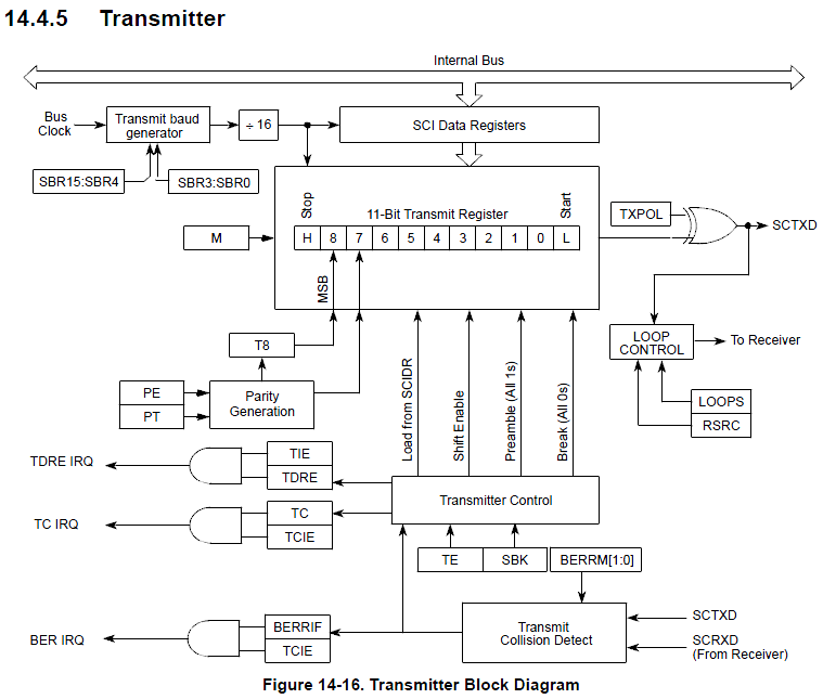

In fact, the LOOP CONTROL does not need to be enabled for sending break signal.
If you set SCI0CR1_LOOPS bit and clear SCI0CR1_RSRC bit, the transmitter output is internally connected to the receiver input. When you set both these bits, the transmitter output and receiver input are connected at pin level (Single-wire mode). None of these settings are valid for proper LIN communication.
If you are not able to receive break signal without loop mode, the issue might be in LIN transceiver (LIN PHY). When MCU something sends on TX pin connected to LIN transceiver, the same data should appear also on RX pin with some very small propagation delay.
Are you sure, that LIN PHY is correctly enabled and configured (no errors signalized)?
