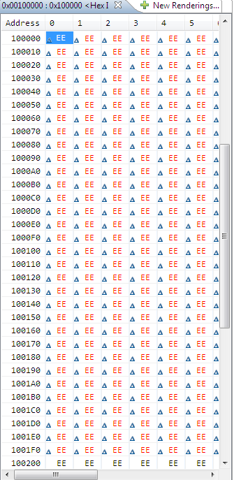

I want to test Watchdog reset abnormality for S12ZVMl128.
Accoarding to me, when I will write garbage value other than 0x55 and 0xAA to CPMUARMCOP register watchdog will get reset and the COPRF flag will be raised.
In my code,when i write garbage value to CPMUARMCOP register the EEPROM will get written by oxEE.
So I am not getting this behaviour why this is happening,Please provide some solution for this.
1,959 Views
lama
the triangle, in front of value EE (in the memory window), says that the value is not updated/refreshed/known. The reason is the COP and communication with PC. The COP is normally not debuggable because it is an reset and the communication between debugger and MCU is lost. The best way is to debug and set behavior of the CPU at the beginning of the project and then implement it into a project. Next possible debugging is to signalize COP by diodes or use UART (SCI) for sending messages to a PC. I usually use diodes as presented below (tested on TRKS12ZVL). If you want to see correct behavior of the COP the most suitable way is to disconnect BDM from the board and start the MCU by power on or reset button.

lama
the S12Z family device reset source recognition is not affected by size of capacitor at the reset pin as it was for older types of S12 devices so there should not be any potential issue or problem with recognition.
Writing any vale to the EEPROM where initial COP setup value can be stored has no meaning for immediate COP reset.
Immediate reset is generated by writing any value to CPMUARMCOP in the registers.
CPMUARMCOP = 0xXX; // any value different from 0x55, 0xAA number flow.
I am sorry but I do not understand the sentence:
"In my code,when i write garbage value to CPMUARMCOP register the EEPROM will get written by oxEE."
...part "the EEPROM will get written by 0xEE."
??? CPMUARMCOP does not changes EEPROM. The EEPROM can only store initial value for COP period in the FOPT space which is loaded into CPMUCOP in inverted value during reset. (see 1.12.1 CPMU COP and GDU GSUF Configuration)
So, could you please send me short example what you are doing to better understand your issue.

Above is the part of my code for watchdog test.
When enabled the macro COP_WDG_RESET_TEST and after running the code the EEPROM will get written by 0XEE as below,
I am not getting the reason behind this.
Please help me for the same.
