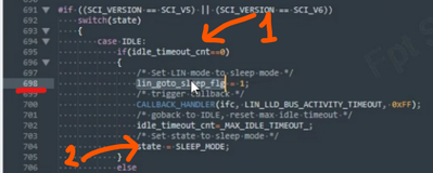

I got informed that this below function will count the timeout
Once the function reaches the timeout, it'll call the Gotosleep function, then the flag of Gotosleep should be set and then if you call the get status function, it should return the set flag.
Please set a breakpoint at this line and observe the bit lin_goto_sleep_flg be set or not.
The state from IDLE will be changed to SLEEP_MODE if the timeout_cnt be counted down to 0.
After that, the lin_word_status.word will be updated through lin_update_word_status_lin

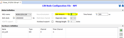

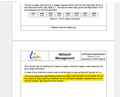

NamLee
Hi NoahXu,
In Lin stack specs, there's a note of this one when master bus was down or inactive atleast 4s to 10s.
This parameter can be configured here
So after this time, the go to sleep bit should set to 1.
Please help me to check and try again.

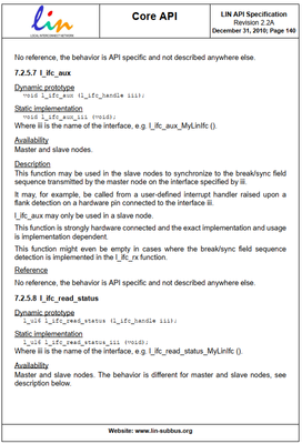

NamLee
Hi NoahXu,
In the LIN API Specification document, you can find a chapter 7.2.5.8 of l_ifc_read_status
This api can be applied for both master and slave side, the return frame will be different
As the response when master stop sending out frames, there should be master in sleep mode. Please take a look at this chapter and these other's return values also.
