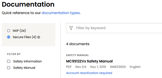

Please refer to the MC9S12ZVx Safety Manual for more information about functional safety.
It is available in S12ZVC Secure File under NDA:
https://www.nxp.com/products/processors-and-microcontrollers/additional-mpu-mcus-architectures/s12-m...

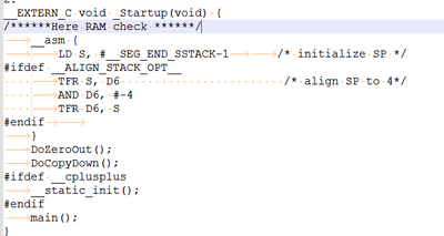

I want to use the S912ZVML12 chip to do initialize perform a RAM check. The method for checking is
Firstly, write RAM to 0 and check if 0 is read out until all RAM is confirmed
Secondly, write RAM to 1 and check if 1 is read out until all RAM is confirmed
Thus completing the initialization check of RAM.
But I have 2 following questions:
Question 1: I don't know how to write assembly code for writing and reading to RAM. How should I write it.
Question 2: Where should this detection method be placed, I think this part of the code should be placed in the position shown in the following figure,is that right?

The MCU initializes the SRAM to all zeros after each Power-on reset.
It is discussed here:
https://community.nxp.com/t5/S12-MagniV-Microcontrollers/initialization-RAM-check-for-S12ZVL128/m-p/...
If you decide to do it in SW, it should be done after RDY = 1, refer to the DoZeroOut() routine.
