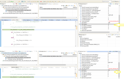

hello, support
 how can i detect if LIN command from LIN master is off by using S12ZVM LIN stack ?
 is there any flag i can use if the master stop sending out LIN command to slave?
i am now using the S12ZVM LIN stack .
thanks!

i set some flags in the code, seems value in freemaster not change if i switch the master comamnd on and off. can you help to check?
the code is set like this
lin_Status = l_ifc_read_status(LI0);
if( lin_Status & 0x0001u )
Lin_flag_errorResp = 1;
else
Lin_flag_errorResp = 0;
if( lin_Status & 0x0008u )
Lin_flag_gotoSleep = 1;
else
Lin_flag_gotoSleep = 0;

NoahXu
Hello, Namm
"switch the master comamnd on and off" , it is the LIN scheduler on/off simulated by tools like Canoe, by turn on /off of the LIN scheduler, i simulate the LIN master on/off.
the result of the function : i_ifc_readstatus(LI0) is 0XFE30A0 which is really strange. i paste the screenshot of codeworrior IDE here. you can check it.
by the way,  lin trasmit functions is ok using this LIN Stack, which means the cfg of lin stack is ok.
please kindly help to check, thanks

NoahXu
Hi, Namm
you are right, it is the address of the function .
but i checked the value and found no change of it.
in the picture i post here , you can find the register SCI0SR1 is changing when i turn on / off the LIN scheduer , but the variable"lin_Status " is still 0.
