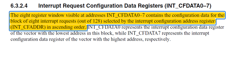

Hi all,
I am using MC9S12XE family microcontroller I want to configure Multiple Interrupts in my device like Timer,SPI,CAN, etc.. while I am going through chapter 6 of Datasheet  I came across this
What I understand from the above context is
I can configure only 8 Vector Interrupt Requests  out of 128 vector interrupt request selected by the INT_CFADDR
for Example
if I am given
/*Ignore programming Syntax*/
IVBR= 0xFF;
INT_CFADDR=0xA0;
then starting from 0xA000 -0xA007 only these Vector Interrupts I can Configure in INT_CFDATA0-7
What about the other Interrupts If I need to configure?
If you look into the interrupt  vector Table of micro controller  present in DataSheet SPI0 interrupt vector location(0XFFD8) AND CAN0 Transmit Interrupt location is (0XFFB0)
CAN0 Receive Interrupt location is (0XFFB2)
so I can't configure CAN0 interrupts along with SPI0 interrupts at a time
Same thing with other Interrupts also ..
This is what I understood after reading the those Interrupt configuration Registers in chapter 6 of Datasheet
Now my question is
1.So How Can I Overcome this problem by using this micro controller family?
2.So How can I configure the other interrupts like CANTx,CAN Rx,SPI along with Timer Interrupt ?
If My understanding is wrong Please Excuse me, and please tell me the correct way of configuring the Multiple Vector Interrupt requests

You don't need to touch INT_CFADDR and INT_CFDATAx at all, unless you want to enable interrupt nesting. If nesting is required (bad idea usually), then still you are not limited to 8 levels. To save precious address space 8 INT_CFDATAx registers are paged. Changing INT_CFADDR you map to INT_CFDATAx different 8 interrupts priority registers. From CodeWarrior project wizard created project with XGATE enabled:
#define ROUTE_INTERRUPT(vec_adr, cfdata)                \
  INT_CFADDR= (vec_adr) & 0xF0;                         \
  INT_CFDATA_ARR[((vec_adr) & 0x0F) >> 1]= (cfdata)
  ROUTE_INTERRUPT(SOFTWARETRIGGER0_VEC, 0x81); /* RQST=1 and PRIO=1 */
You can use ROUTE_INTERRUPT macro to set up interrupt priority of selected interrupt. As you may see, first INT_CFADDR is modified, which maps different 8 vectors to INT_CFDATA , then specific INT_CFDATA is modified with specified cfdata priority settings.
^^ this is used both to redirect specific interrupt to XGATE (2nd argument has bit 7 set), and to set interrupt priority. So to let SOFTWARETRIGGER0 be handled by CPU and set interrupt priority to 3 you call this macro with RQST=0 and PRIO=3:
ROUTE_INTERRUPT(SOFTWARETRIGGER0_VEC, 3);
Edward

What should I do when I have multiple source of interrupts
for example
I have PTI and CAN Interrupts which are located in different vector locations of a vector Table
If I use
ROUTE_INTERRUPT()
function for PTI
and
ROUTE_INTERRUPT()
function for CAN  in same code
 After Configuring of CAN interrupt vector location  and priority using ROUTE_INTERRUPT()
what happens to PTI interrupt   and priority configurations  in CFADDR and CFDATA registers which were configured earlier ?
If you provide an example it will be helpful
Thanks in advance

  • If I use
  • ROUTE_INTERRUPT()
  • function for PTI
    and
  • ROUTE_INTERRUPT()
  • function for CAN  in same code
  •  After Configuring of CAN interrupt vector location  and priority using ROUTE_INTERRUPT()
  • what happens to PTI interrupt   and priority configurations  in CFADDR and CFDATA registers which were configured earlier ?
Nothing happens, PIT priority doesn't change after configuring CAN priority.

Is there any Default Priority to all 128 interrupts that micro controller follow i.e,
if don't configure any priority at all using priority configuration registers(IVBR,CFADDR,CFDATA)  what Micro controller does if any interrupt occurs ?
Thanks in advance
5,139 Views
kef2
Senior Contributor V
Yes, if you look at
Interrupt Request Configuration Data Registers (INT_CFDATA0–7)
, reset default value for PRIOLVL[2:0] is 001.
Edward
