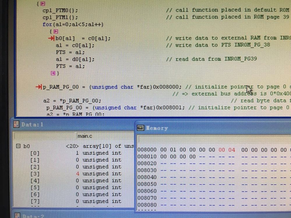

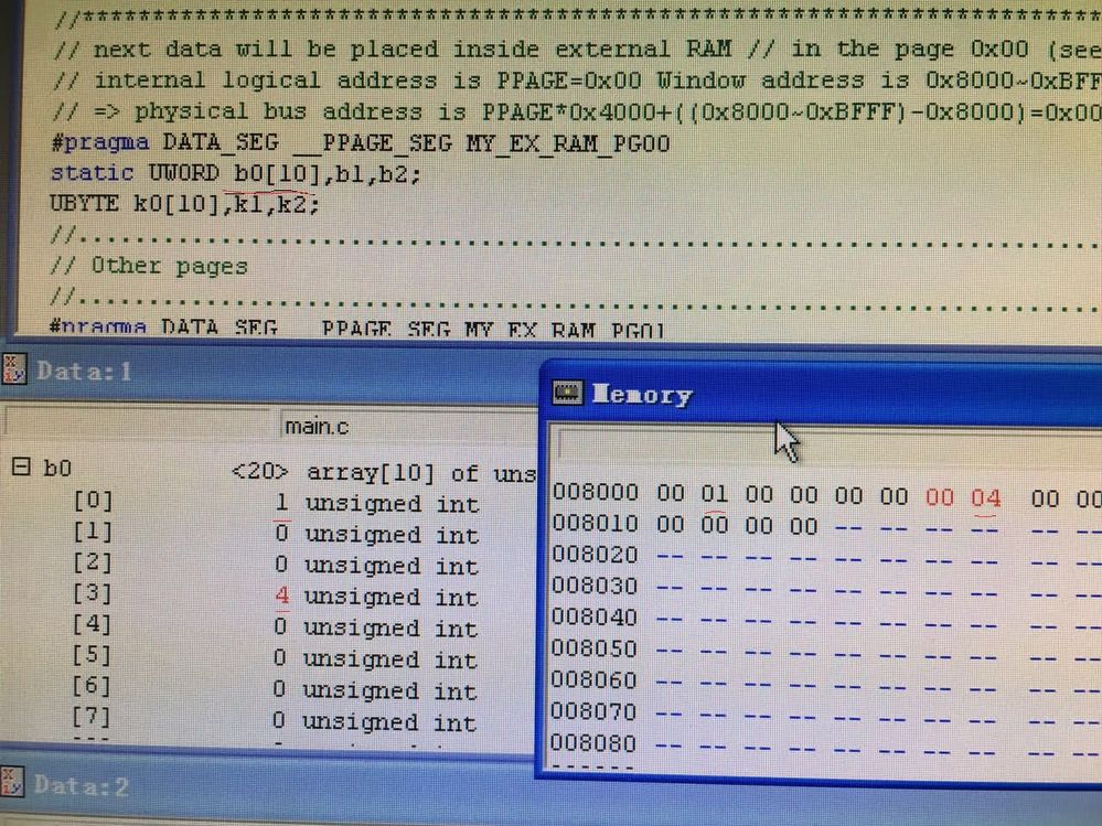

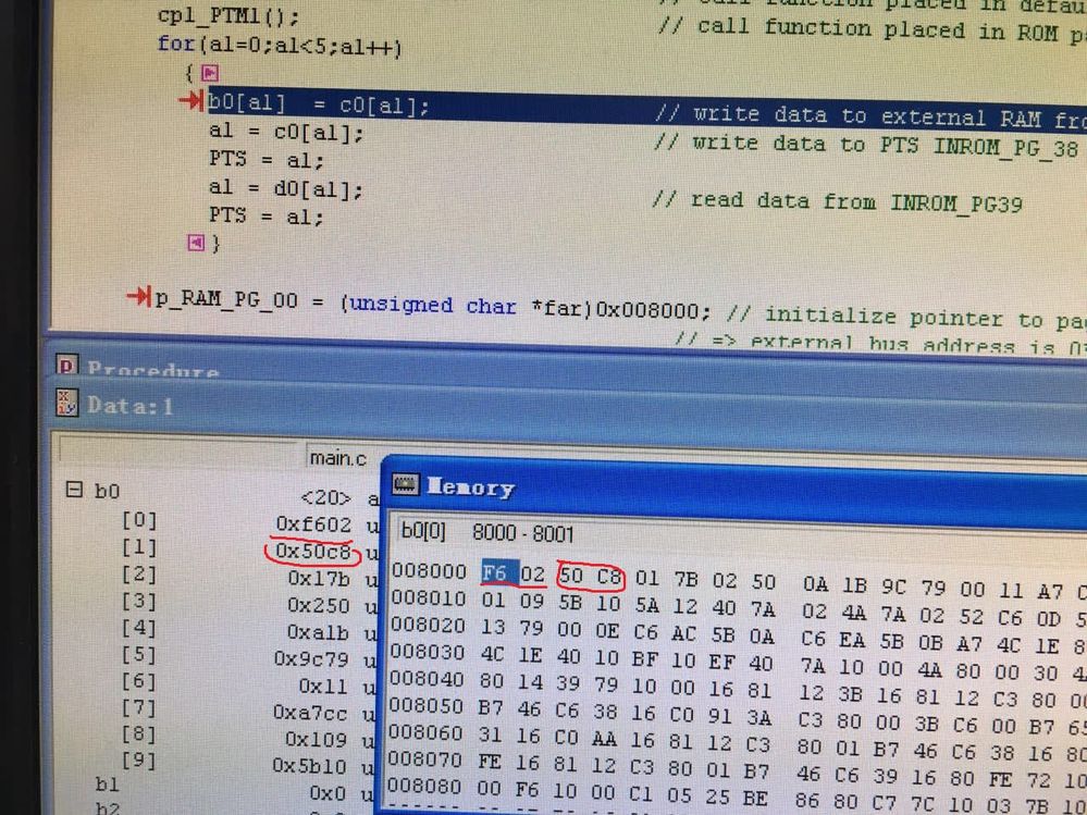

     Now I still have a problem.I have created a new project just like the one you gave me.When I run my program in full_chip_simulation Mode,I can access any address,internal or external .I think it is a great advance.But when I put my code  on chip (mc9s12kt256),and run ,it just cannot access external address,all accesses become internal ,i donot know why.
     And my simulator is P&E USB BDM Multilink.
     1. simulation ,everything is OK.
     2.on_chip mode, the same case,it reads from internal memory.I donot connect any physical memory to KT256.
